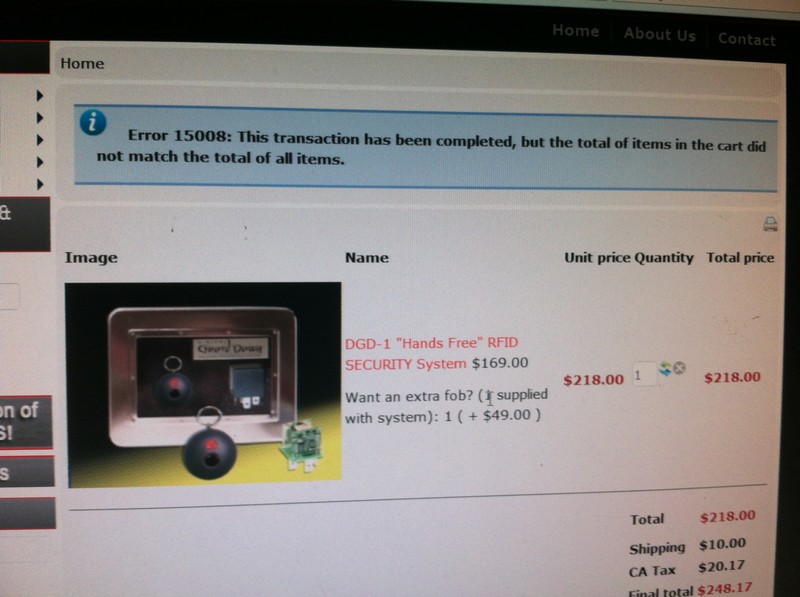

  • Posts: 279
10 years 7 months ago #162409
I hope it's OK to resurrect this old thread. I thought about starting a new one, but this scenario is exactly my problem.
Joomla 2.5.22
HS Essential 2.2.2
Payment plugins: PayPal & PayPal Pro (for credit cards)
I do have "Send details of the order" set to yes in the PP plugin.

  • Posts: 279
10 years 7 months ago #162689
I've turned off "Send details" and we'll see what happens. I get a funny error saying I don't have a valid account when I try to upgrade. I also made some hacks to the HS files to get the display looking right which (yes I know, stupid me) I didn't document, so I need to work through the files I fiddled with to document the changes before upgradign anyway.
