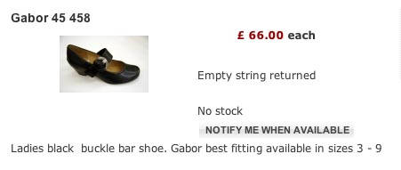

The result:
I know for a fact that the over-ride is being called; if I remove the ';' from the end of the '</table>'; line, I get the error 'Parse error: parse error in /Library/WebServer/Documents/peaklander/templates/peaklander/html/hikashop_characteristics.php on line 16' - which is the break; that follows it.
From this it is apparent that the $html being passed back, on arrival in characteristic.php, is empty and characteristic.php creates the drop-down accordingly. Any ideas as to why $html is empty?
Martyn.

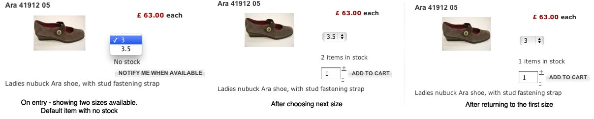

Right, I have written the over-ride to populate the drop-down only with items that have stock, i.e. none-zero, but it's not quite there yet.
I have a product that has 15 variants, 2 of those items have a positive stock level, the remainder are set at zero. The default (selected) item for the drop-down is one that has no stock. In my code I check to see if the default item has stock. If it hasn't then I set the default (selected) item to be the first item that has stock:
if(!$default_item_has_stock){
				$obj->characteristics[$first_characteristic_parent_id]->default->variant_characteristic_id = $first_variant_characteristic_id;
				$obj->characteristics[$first_characteristic_parent_id]->default->variant_product_id = $first_variant_product_id;
				$obj->characteristics[$first_characteristic_parent_id]->default->ordering = $first_ordering;
				$obj->characteristics[$first_characteristic_parent_id]->default->characteristic_id = $first_characteristic_id;
				$obj->characteristics[$first_characteristic_parent_id]->default->characteristic_parent_id = $first_characteristic_parent_id;
				$obj->characteristics[$first_characteristic_parent_id]->default->characteristic_value = $first_characteristic_value;
				$obj->characteristics[$first_characteristic_parent_id]->default->characteristic_alias = $first_characteristic_alias;
				$default_characteristic_id = $first_variant_characteristic_id;
I have used a print_r in the 'characterisitics.php' code that calls the override and can confirm that the default section is as set with the above code.
On choosing the product on the front end, the first item is listed in the drop-down, but it shows as having no stock - which is not the case.
Choose the second item on the list and it shows the stock level. Now choosing the first item on the list shows that it has stock. See the graphic.
If I go the the back end and set the default item for this product to either of the items that are in stock, it works as expected.
It seems logical that the display of the 'No stock' / 'Add to cart' would be derived from the $element->main->characteristics array. Is this the case? Or is there some other area in the array that the changes need to be made? I've looked through the array but can't see any other places where a change could/should be made.
The only other resolution I can think of at the moment is to update the database with the new default item. I don't want to do that if it can be helped. I'd much prefer a cleaner, more elegant solution. Neither am I convinced that this would solve the issue.
Any help/guidance would be appreciated.
Martyn.
Last edit: 12 years 10 months ago by expertbeginner. Reason: removed 'all but' from 'all but 2 of those items'

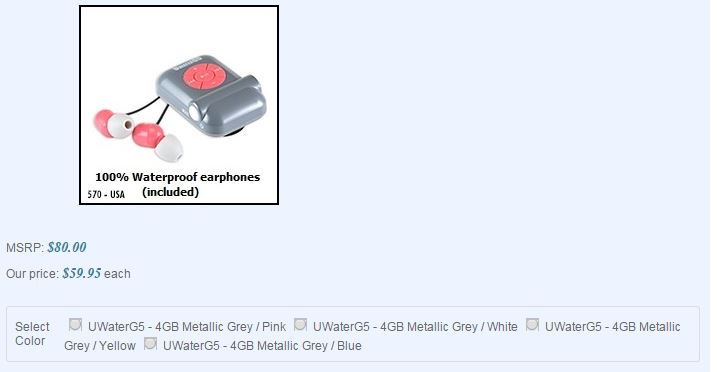

I did figure out how to use the characterisitics. But they show as radio buttons , is it possible to change them to a drop-down list. Also how can I add images to the list?
I attached a pic of the radio buttons list.
