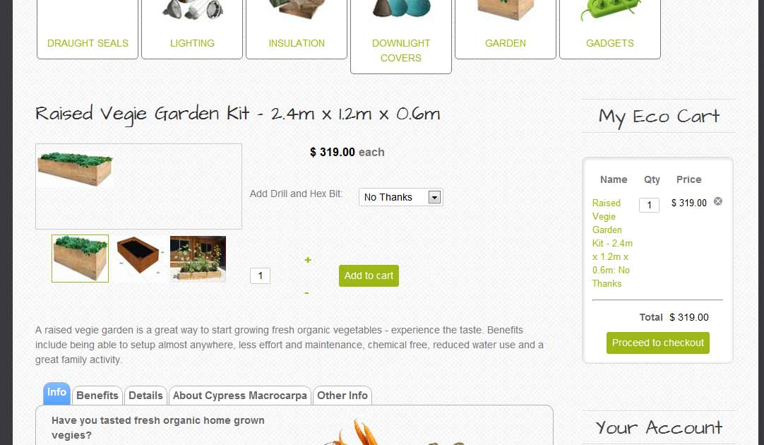

Have attached an image of the product page currently on my site (Mockup). I am having trouble finding where things are in views to manipulate the layout. A couple of things.

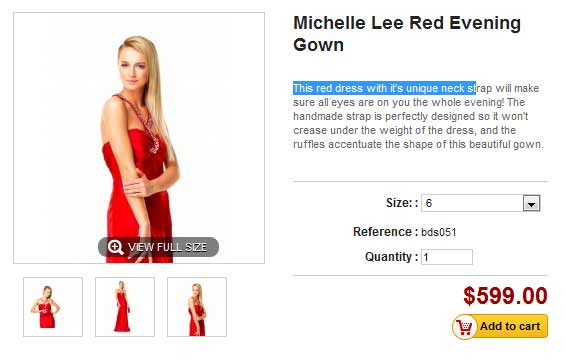

I want to basically make the Hika layout look like that shown in Mockup2 image (which is prestashop)
How do I make the Main product image larger (the thumbnails below are ok)?
It looks like that if things aren't being used such as vote, or dimensions - it is leaving blank space where they are normally located - you can see the spacing. Not sure how to stop this.
How do I get the intro text (before the readmore in my product description) to sit on the right hand side where the price and characteristic currently is.
My order would be
Product Description
Characteristics
Quantity
Price
Add to Cart
Much the same as the Mockup2 image,
I want to add the word quantity in front of the text box as well - not sure which view
Hopefully this makes sense

you seem to have a LOT more description (intro text) in your product in mockup than mockup2 ? are you going to have less inf on you site, its nice having it below so you can show as much information as possible. If you do want it on the right hand side its just a matter of moving this information in the Display -> Views -> file if your using commercial edition of Hikashop.
The bit below :
<div id="hikashop_product_description_main" class="hikashop_product_description_main">
<?php echo JHTML::_('content.prepare',preg_replace('#<hr *id="system-readmore" */>#i','',$this->element->product_description)); ?>
</div>
Is currently located in <div id="hikashop_product_bottom_part" class="hikashop_product_bottom_part"> move it to just under <div id="hikashop_product_right_part" class="hikashop_product_right_part">.

That isn't working - it puts ALL the product description in - I only want the section above the readmore which is the intro text.
I might be doing something wrong though
  • Posts: 179
  • Thank you received: 17
12 years 10 months ago #52079
ok this will do the job then :
<?php
echo preg_replace('#<hr *id="system-readmore" */>.*#is','',$this->row->product_description);
stripped from the listing products, please be aware if you have any code such as tabs etc above the intro text that comes across as well, so you have to format it right :)
  • Posts: 301
12 years 10 months ago #52146
Thanks - that worked. The only problem was it doesn't sit to the right of the images now - it drops everything below the product images. Tried a lot of things to get it to sit on the right but to no avail. Will need to look at that on a rainy day when I get time.

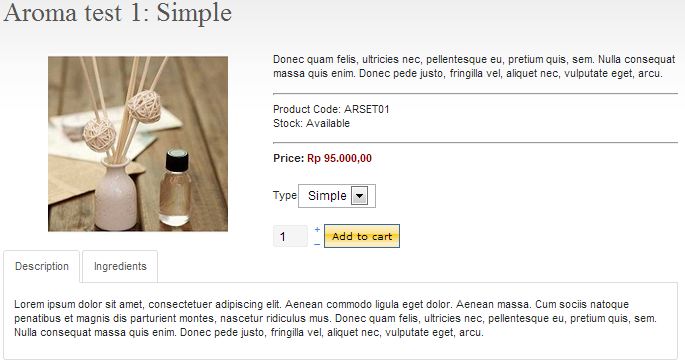

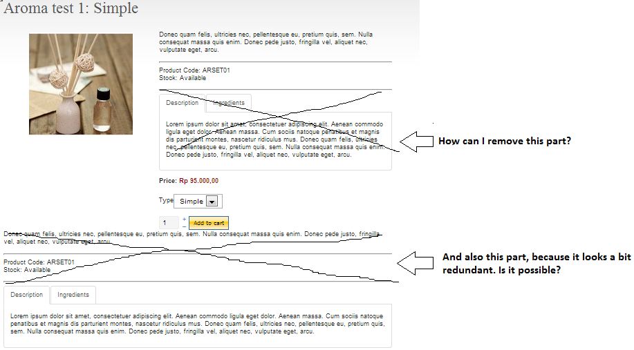

Hi first of all, thanks for this thread Huski and rikatos. I have followed the steps and I manage to make the product description to appear on the right part. However, it puts everything in there including tabs where I actually want only the description before the tab. I have tried to fix it for some time but to no avail. Huski, you managed to fix it, what exactly did you do?
Please see the screenshots attached. Mockup is as-is and Mockup2 is to-be.
Many thanks in advance guys.
Last edit: 12 years 1 month ago by max.mandias. Reason: more clarity

12 years 1 month ago #95774
Basically you are talking like my quote site ?
www.glcportal.co.uk/leisure/product/560-kru-xs-iso.html
Just that I have removed pricing:)
  • Posts: 12
12 years 1 month ago #95775
Yes! I want it exactly like that. What should I do now?
  • Posts: 179
12 years 1 month ago #95785
From my memory all I did was change product/show.php files within hikashop (Display..Views..Filter by Front end and your template).
This allows you to edit the override file (ie if you mess it up you just get rid of your override and all returns to default).
I will pop across (attached) my show.php file so you can paste over and see if it fits your needs. Naturally I recommend doing on a test site not a live one !
Last edit: 12 years 1 month ago by rikatos. Reason: attachment
