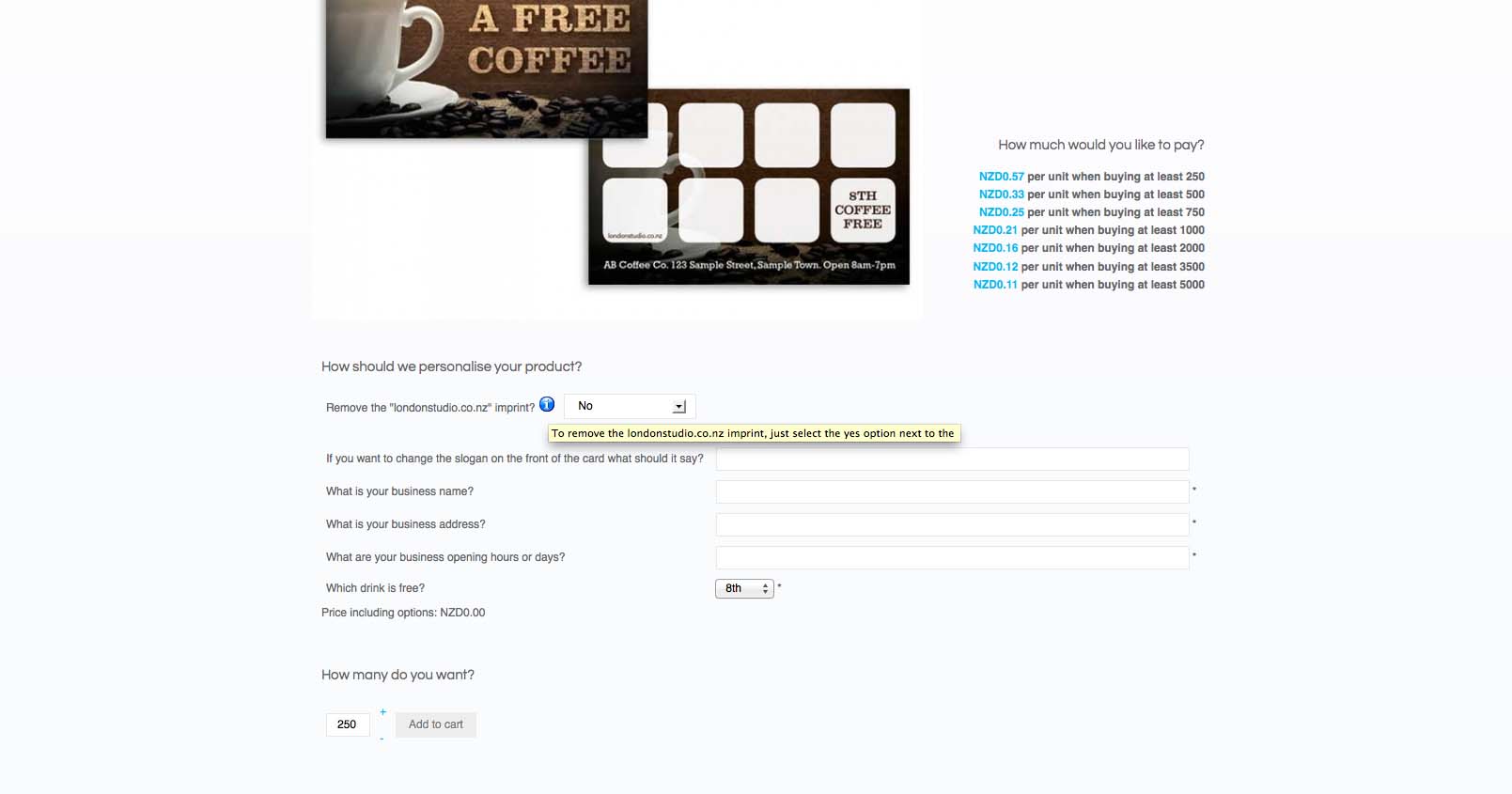

My products have one product option. This option has a description to better explain the product option. This description on the front end displays as a "i"
However when the user mouse hovers over the "i" in the front end half the description gets cut off.
Does anyone know how to fix this?

I am not using any HTML in the description, Just an line of text styled in the default "paragraph" style. Could HTML be coming from my joomla template. If so how do I override my template so the text is plain? so it will display correctly.

14 years 3 months ago #52320
Here is a link to my products page. There is only one option and this same option is applied to all products.
www.londonstudio.co.nz/index.php/the-sho...oyalty-card-design-2
I have tried formatting the description in both "paragraph" and "preformatted" and neither fixes the problem.

Could you also give the exact HTML code that you set in the description ?
Looking at the code of the page, I would say that it comes from the description itself.
One option might be to change the line:
$description = strip_tags(JHTML::_('content.prepare',$optionInfo->product_description));
to:
$description = $this->escape(strip_tags(JHTML::_('content.prepare',$optionInfo->product_description)));
in the file "option" of the view "product" via the menu Display->views, so you might want to try that.
The following user(s) said Thank You: londonstudio

Thank you Nicolas, That worked. Once again you provide amazing support.
