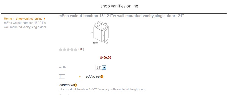

I add the "width" as variant to the product,and editted the variant ,that means different width has its own description,code and price. But when I click the drop-down menu choice of "width", the description of the main product doesn't get any change, it still shows the width range only. See attached picture.
Is it possible to get the description change with the width selection?

Here is the screen shot when I click to select "21 inch", the product description still shows as:
... 15"-21"w wall mounted vanity,single door, while it is supposed to change as "...21" vanity". It should be defined as a set width instead of a width range.
Please advise the solution to it.

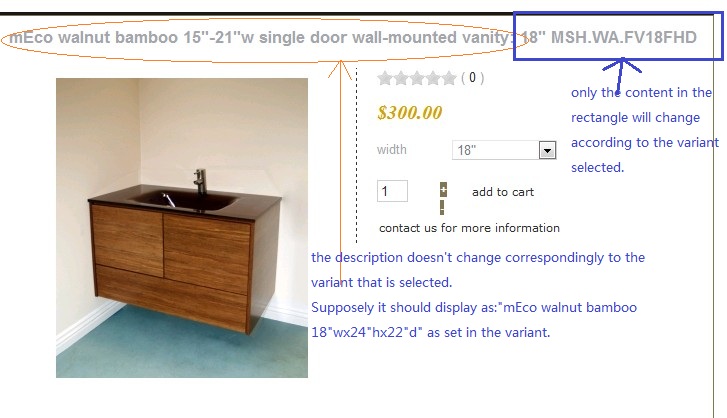

  • Posts: 76
12 years 9 months ago #52994
Here is the screen shot, i've circle it out.
Please advise the solution.
  • Posts: 76
12 years 9 months ago #52995
Nicolas,
Re-attach the screen shot, hope it's clear this time.
  • Posts: 83402
  • Thank you received: 13495
12 years 9 months ago #53097
That is not the description but the product name.
The description is at the bottom:
dimension: xxxxxxxxxxxxxx
xxxxxxxxxxxxxxxxxxx
xxxxxxxxxxxxxxxx
That's why I was confused...
MSH.WA.FV15FHD is actually the variant code.
If you don't want the variant code to be displayed, turn off the "show product code" option of the Display tab of the configuration.
"mEco walnut bamboo 15"-21"w single door wall-mounted vanity" is the main product name. If it doesn't change it probably means that you didn't enter anything in the name field of each one of your variants.
please check on that.

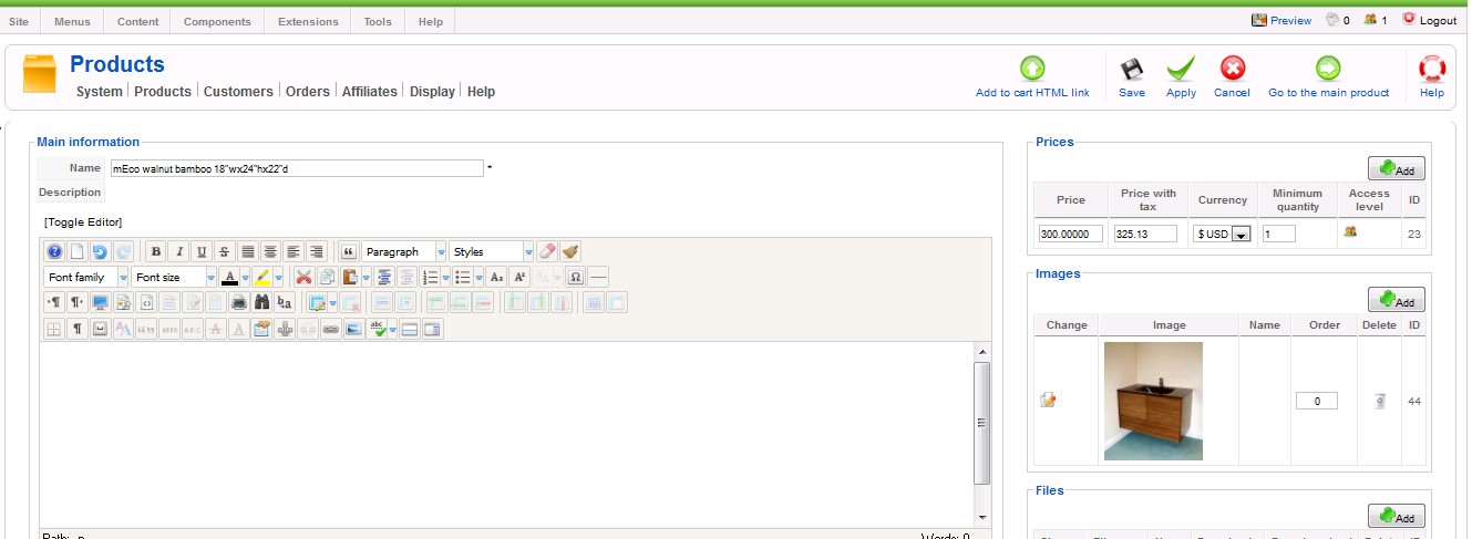

  • Posts: 76
12 years 9 months ago #53198
Sorry to confuse you, I didn't realize we are talking about two different things...hehe...
I did set the product name for each variant, see the screen shot, but the product name still doesn't change corresponding to the size that is selected.

  • Posts: 83402
12 years 9 months ago #53312
Then, make sure that the "append characteristics values to product name" option is turned off in the Display tab of the configuration.
  • Posts: 76
12 years 9 months ago #53324
Yes,now it works! Great! Thanks so much,Nicolas!
