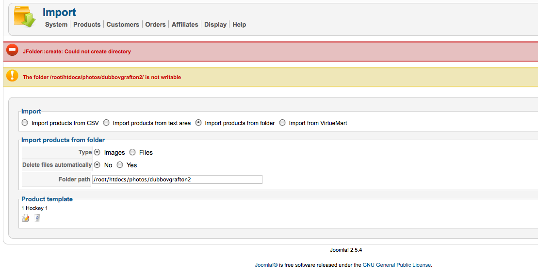

12 years 10 months ago #55253
I am trying to import photos to products without success. I have uploaded all my photos via ftp and ensured all files and folders are writable. I have attached a screenshot of the message i keep getting and the info i am entering. Thnaks
  • Posts: 83674
  • Thank you received: 13545
12 years 10 months ago #55310
Please make sure that you didn't upload the images in the same folder than the folder you set in the "upload folder path" option of the configuration of HikaShop.
Also, turning off the FTP layer of joomla in the configuration of joomla might help.
  • Posts: 40
12 years 10 months ago #55352
The upload folder path in Hikashop is media/com_hikashop/upload/ which is different to where i have placed my images (/root/htdocs/photos/dubbovgrafton2). My ftp setting is also set to No. Thanks
  • Posts: 40
12 years 10 months ago #55437
Just so you know I am using filezilla to upload my images because I have so many.
  • Posts: 83674
12 years 10 months ago #55514
Then try to change the permissions of that /root/htdocs/photos/dubbovgrafton2 folder to 777. That should hopefully avoid the problem.
  • Posts: 40
12 years 10 months ago #55538
I have the permissions of that folder also set to 777 and its still not working?
  • Posts: 83674
12 years 10 months ago #55541
There is still a problem with that folder. If joomla says it can't write in it, then it means that there is a permission issue on the folder. There is no other reasons I can think of.
Let's go around the problem and change the line:
if(!$fileClass->checkFolder($uploadFolder)){
to:
if($delete && !$fileClass->checkFolder($uploadFolder)){
in the file administrator/components/com_hikashop/helpers/import.php
That should avoid the problem.

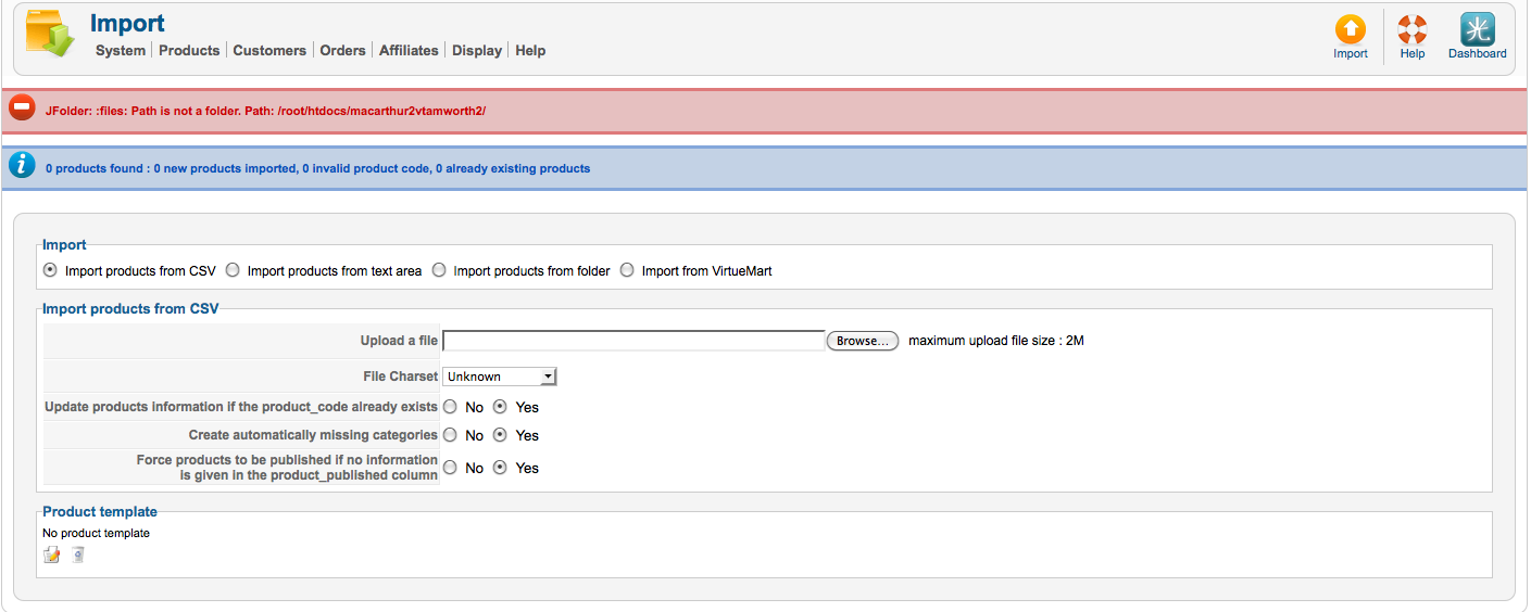

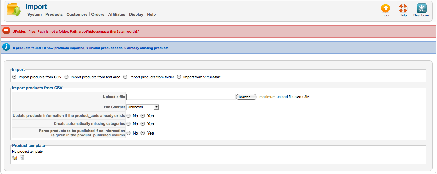

  • Posts: 40
12 years 10 months ago #55545
No that hasn't helped either. I now get the following. Is it possible for me to send the login details for you to take a look
  • Posts: 83674
12 years 10 months ago #55548
It worked actually... It let the system proceed to the next step.
Apparently, the path that you gave to the import is not correct.
Path is not a folder means that the path is not correct. That's probably why the system wouldn't be able to write in it.

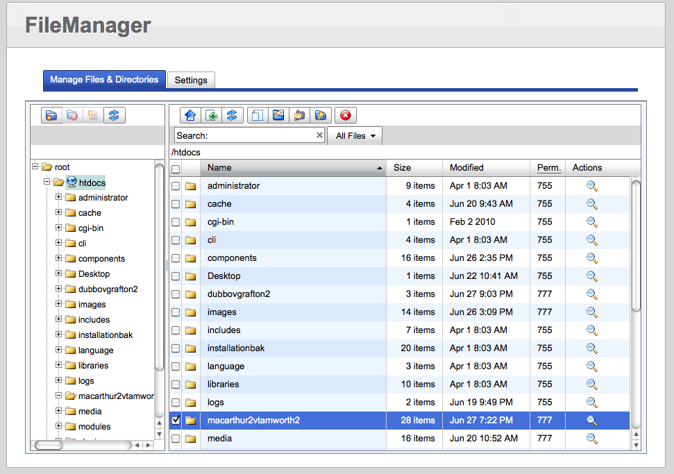

  • Posts: 40
12 years 10 months ago #55566
Hi. Sorry but we are still having trouble identifying our absolute path. Please find attached a snapshot of our file structure. It highlights the folder we wish to use - macarthur2vtamworth2. THe site url is vixpixphotography.com
Are you able to define the absolute path from this information.
THanks
  • Posts: 83674
12 years 10 months ago #55568
That's the structure of your website folder.
But that doesn't give any information on the folders in which the website is located on the server.
The simplest will be to enter the relative path of your folder from your website's root directory. So it should be just the name of your folder, without any slashes.
