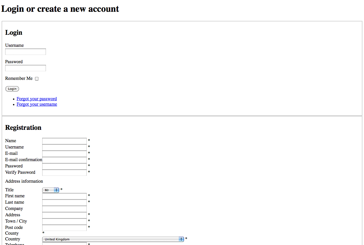

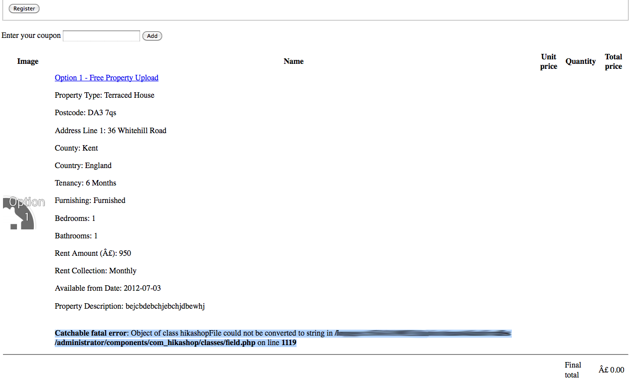

  • Posts: 47
12 years 7 months ago #56523
Unfortunately this has not worked - since I have put the new files in it has caused a new error. Now, after a user fills out the userform and then clicks add to cart, the page it directs to is broken (template doesn't work etc - I have attached a screen dump of it) and I get the following error message "Catchable fatal error: Object of class hikashopFile could not be converted to string in /mywebsite/administrator/components/com_hikashop/classes/field.php on line 1119"
As a result of this I have had to switch back to the old files otherwise my website is not working at all and people cannot buy anything.
Please can you urgently look into this for me.
Thanks very much,
Keith
