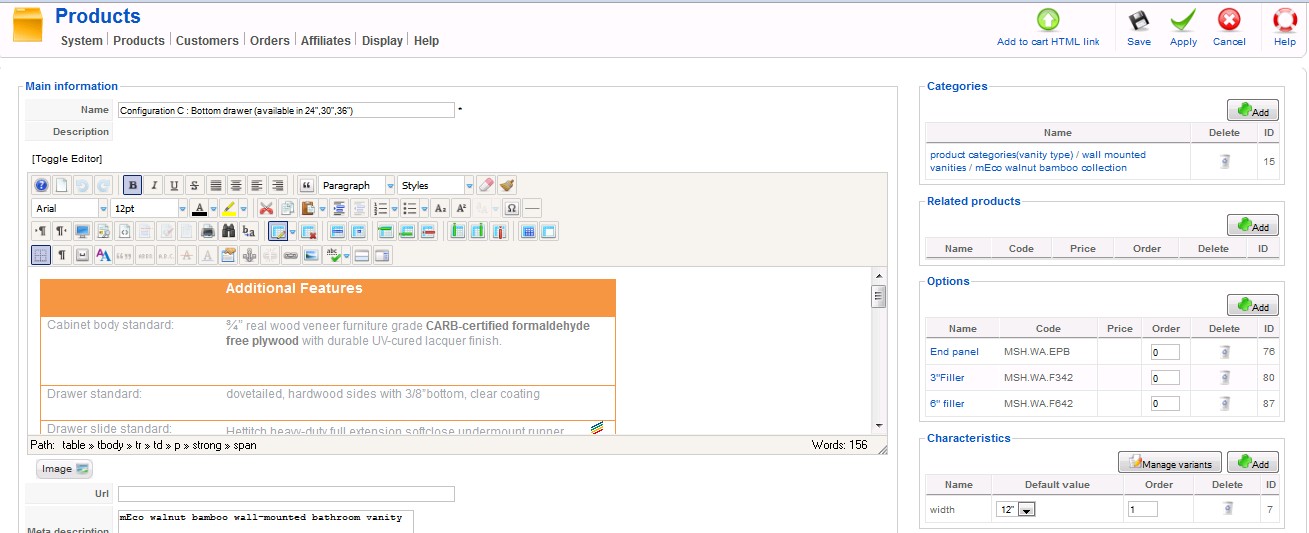

12 years 7 months ago #55961

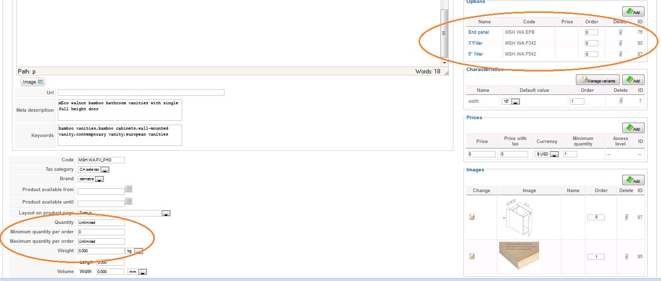

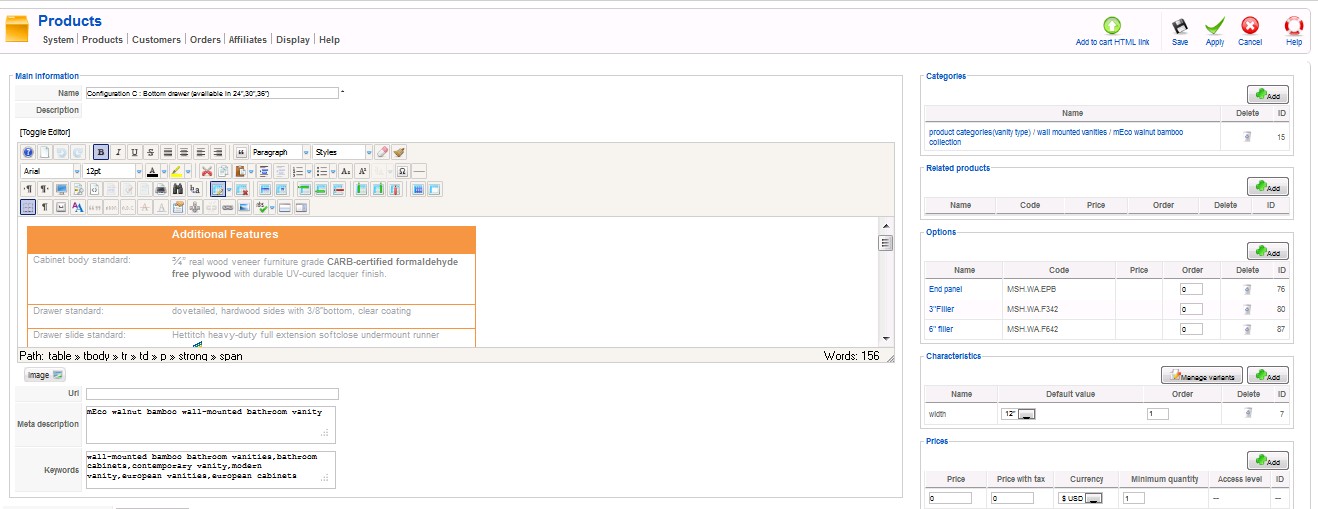

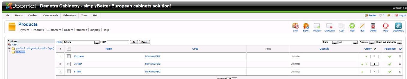

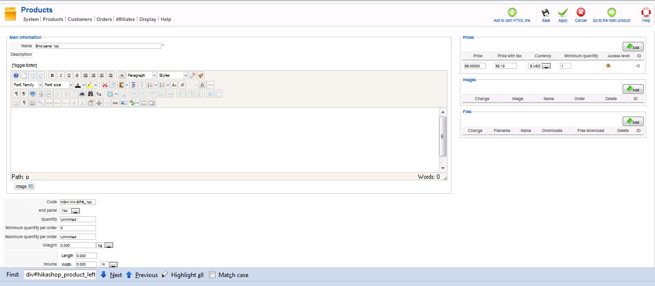

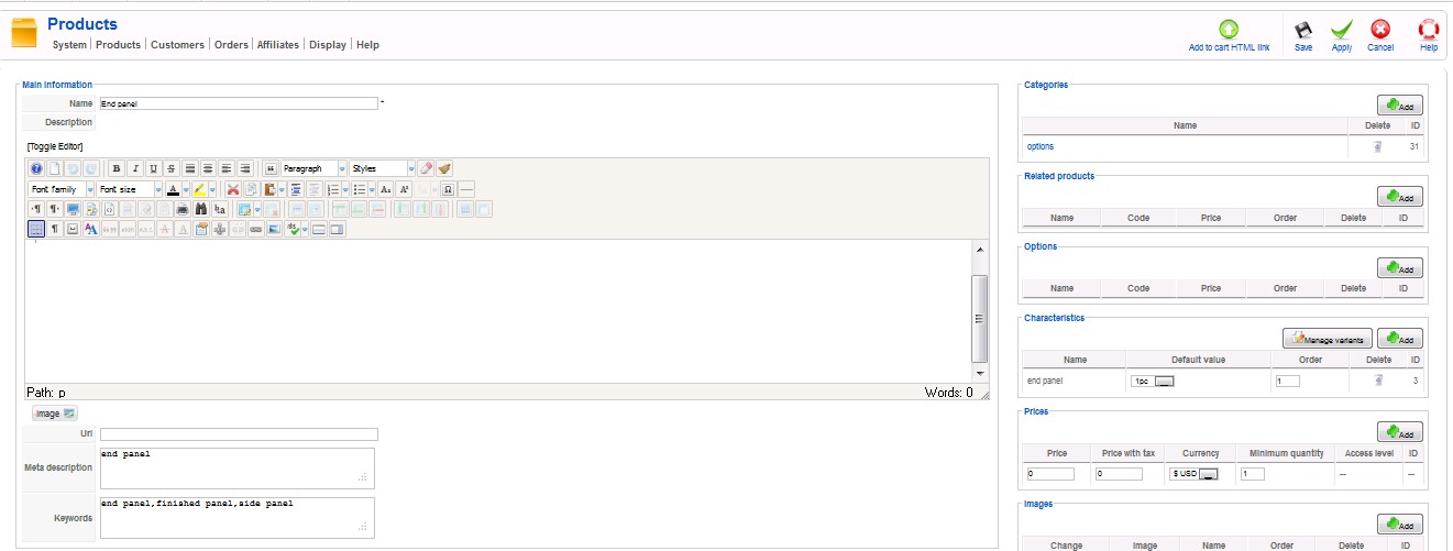

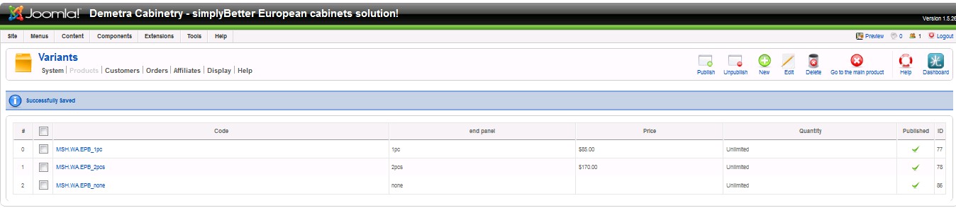

Can you do a screenshot of your main product, its options and its variants edition pages so that we can see how you configured all of that ?
There must be a problem with some of their quantities.
  • Posts: 76
12 years 7 months ago #56017
See attached.

12 years 7 months ago #56051
It would help if you could include the quantity/min and max quantity fields in your screenshots.
And maybe explain which one is for which part of your products.
  • Posts: 76
12 years 7 months ago #56191
See attached. I didn't set any min.or max quantity for the product items and its variants, neither did the option items.

I checked your website and the problem came from a modification you had done in the "show_default" file of the view "product" via the menu Display->Views which broke the HTML of the page.
I've fixed it and it's working fine now...
