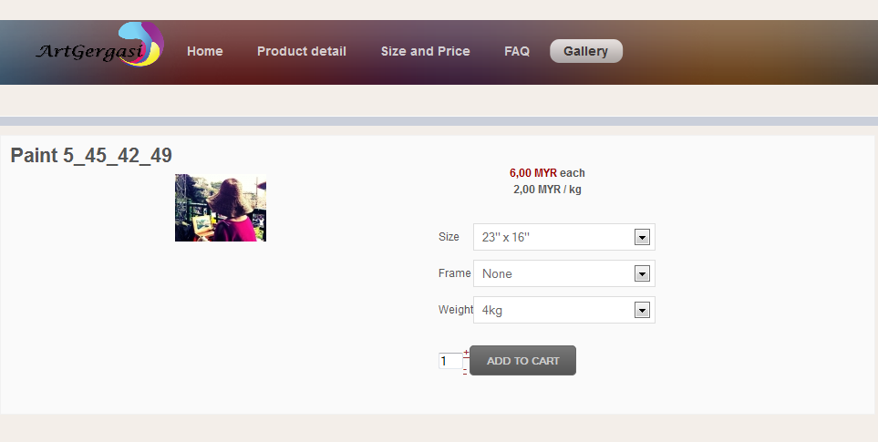

thx ya but may i ask wat is d number around dere (45_42_49) i think i din set this up anyway can i disable it?

That number is the product code. You can remove it by turning off the "show product code" option of the configuration.

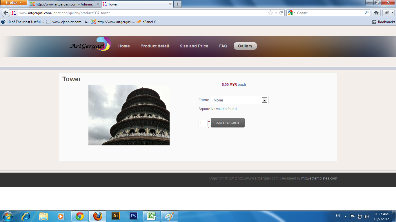

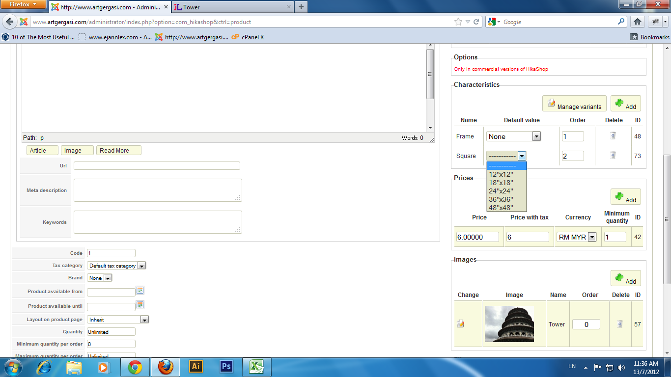

Sorry ya i noe getting annoying cos too many problem i hv but may i noe y d product dere show no value found? i hv set d price like in d attachment there...

3. That's because you added the characteristics in two times. You should add them both at once. Please follow these steps and it will work:
1. Delete all the variants of the product on the listing of variants that you can access via the button "manage variants" on the product edition screen.
2. Delete the characteristics of the product.
3. Save the product.
4. Add the characteristics again.
5. The system will regenerate all the variants automatically and you should be able to see the dropdowns properly on the front end.

dis is my website link...and thanks for the variant problem i solve it ady
