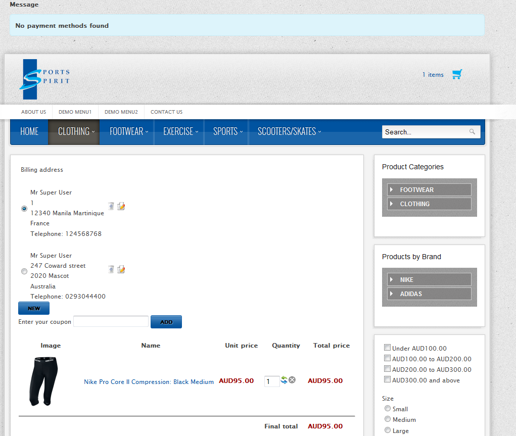

I followed the instructions and when the address is overseas, the user doesn't get the 'Payment Method' option, therefore, cannot proceed with the checkout. On the top of the website, a message appears as 'No payment methods found'.
Functionally this is fine, but is there way that I can do this more 'user friendlier' way. Such as a message on the page where the items are displayed. I have attached a screenshot with how the message is displayed by default.
Many thanks
Chama...

You can for example change the "no payments methods found" translation word by editing the English (United Kingdom) file in "Hikashop->System->Configuration->Language" and changing the line :
NO_PAYMENT_METHODS_FOUND="No payment methods found"
by :
NO_PAYMENT_METHODS_FOUND="your translation"
Hope this will help you.
