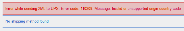

The USA/US zone is set up, chosen correctly in the warehouse section. I'm getting the error message "Error while sending XML to UPS. Error code: 110308. Message: Invalid or unsupported origin country code". I have tried recreating that zone but I still get the same error. Everything seems to be set up correctly so I don't know where else to turn.

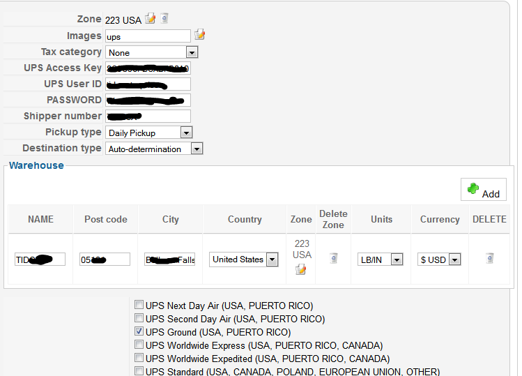

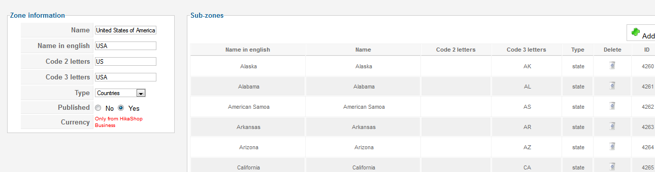

Can you do a screenshot of the UPS plugin options as well as the USA zone ?
Also please make sure hat you selected the United States of America zone and not the United States Minor Outlying Islands.

Here are some screen shots, including what I'm seeing in the shopping cart now.

In the "country" column of the warehouse area, did you check that it was the correct USA zone selected and not the other one ?
That error seems to indicate that the problem comes form there.

I checked your website and you had selected "United States Minor Outlying Islands" in the country column of the warehouse area of the UPS plugin...
Please try again.

Oh - I checked all the zones I guess but I missed that column which only displays the first part of the text. Sorry about that and thanks for your help.
