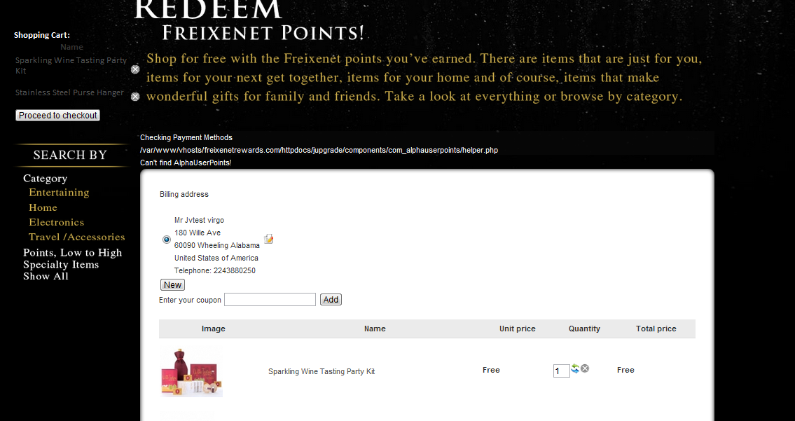

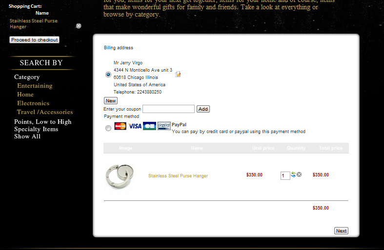

Hi, I have the latest version of alphauserpoints 1.7.4 on joomla 2.5.4 with hikashop 1.5.8.
I attached a screenshot of the alphauserpoints settings as well as how the shopping cart looks on checkout. I want to set it up so that users can only pay with alphauserpoints, however it doesn't display that payment option. I have a test user setup which already has points to purchase items with. I setup the paypal payment plugin for testing purposes (if disabled, it says no payment option available).
Do I have something setup improperly?

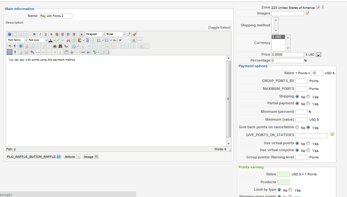

Could you do a screenshot of the options of the AlphaUserPoints payment method and make sure that it is published ?
  • Posts: 18
12 years 8 months ago #59329
Here it is sorry, I attached the wrong file

12 years 8 months ago #59352
My developer put in some echos into the hikashop payment plugin into alphauserpoints in several areas to see where it was breaking. It's saying it can't find the file while checking if it exists, while all other alphauserpoints functionality still works in other components, just not hikashop. Here's a screenshot of the echo.

  • Posts: 83674
  • Thank you received: 13545
12 years 8 months ago #59414
Please remove the zone restriction and the currency restriction from the AlphaUserPoints plugin. Then, make sure that you also set a big maximum number of points (MAXIMUM_POINTS option).
Then, make sure that your user has enough points (more than 10 times the total amount in dollars since 1 points = $0.1) or turn on the "partial payments" option of the AlphaUserPoints plugin.

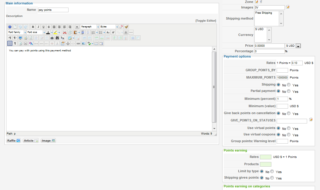

  • Posts: 18
12 years 8 months ago #59508
Thanks for the help. I've adjusted the settings as shown in the attached image. However, it's still having the same problem. I tried it with an item that cost $1 using those settings, and it still displays no payment method.
  • Posts: 83674
12 years 8 months ago #59564
That looks good.

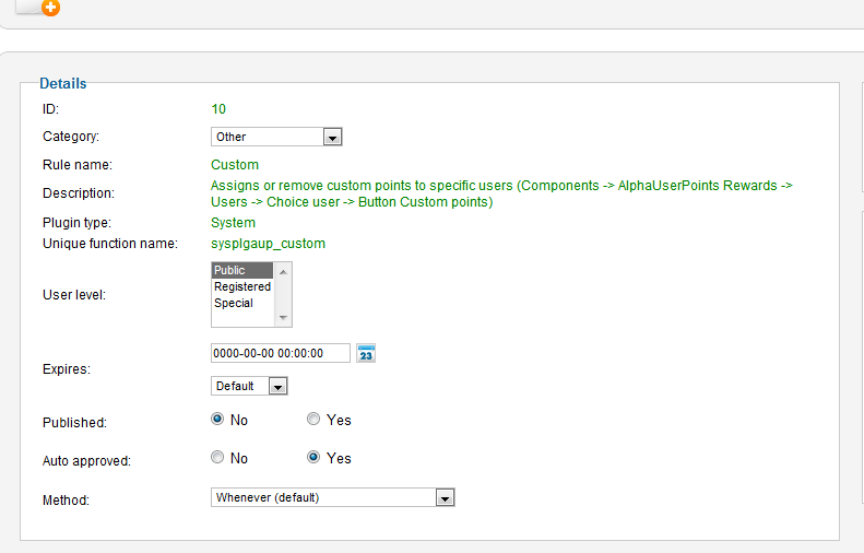

Can you check that the AlphaUserPoints plugin is enabled ?
Also, make sure that the "Order_validation" rule which is added by the plugin automatically is published in AlphaUserPoints
  • Posts: 18
12 years 8 months ago #59588
I checked on both of those, they are enabled.
