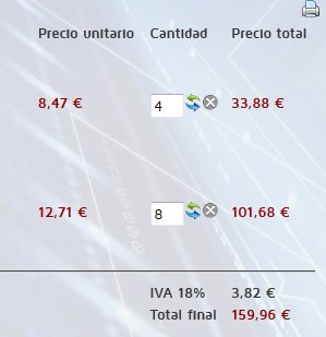

Hi. I wanted to calculate my invoices tax from the sum of the prices without tax of all of the order products, so I installed the custom quantity tax plugin that was made for that purpose. I activate it, went to Configuration->Display and set not to show detailed taxes, but taxes are not showing properly. The checkout is only showing the tax of one unit by line, so is the same tax if I have 1 unit that if I have 10 units. I attach image.
Please help. Thanks.

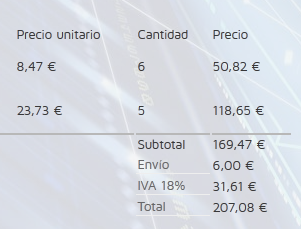

I attach image of a bought who has an incorrect VAT cuote for only a few products. VAT tax is 18% for all these products and for shipping costs too, the order/invoice calculates a VAT cuote of 31.61€ and the real cuote is 31.58€
I've tested to make the calculations by several ways and VAT tax is always the same (31.58€)
It's only a 0.03 cents of difference but it's enough for me to try to find a solution.

These kind of issues where the taxes is not correct with that plugin usually happens with the custom tax plugin when the "show tax details" option is turned off.
Could you double check that setting please ?
If you want to show the tax for each product price, you can change the "show taxed prices" option of the configuration to "both" in the configuration and you will get the taxes for each price of each product line. However, note that the sum of these will of course be different than the total tax since the total tax is recalculated for the whole total and then rounded.

I've tested the tax calculation override plugin and I can't use it because I can have products with different taxes in the same order/invoice and the plugin doesn't separate the taxes quantities, so I made a test too with some products (without the plugin) and I think there could be a bug in normal calculations without using that plugin. I attach the image again and I would like if you could tell me how hikashop arrives to that result on tax quantity.
I've made the tax calculations BY THE TOTAL, also by product price (then calculate the tax BY UNIT and then multiplying by units bought), and also by units bought multiplying by unit price (and then calculate the tax, BY LINE). I don't know if there's someway more to do the calculations, but in all three ways I get a tax quantity of 31.58 EUR (not 31.61 EUR).
Please, if I'm in a mistake, Can you tell me the calculation procedure on how hikashop gets a tax of 31.61 EUR?
Thanks.

12 years 6 months ago #61373
Hello Lanzanet,
I just tried to reproduce the bug you're experiencing and I get the right result as you can see in the attached screenshot.
I activated the tax override plugin in order to get this result and you should be able tu use it as weel since it can handle different taxes in the last version.
Just be sure sure you have the last Hikashop version and you should get what you want.
Last edit: 12 years 6 months ago by Eliot.
