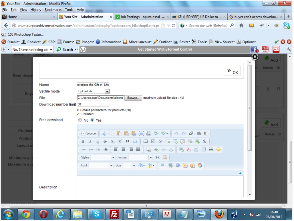

I've attached the image of the uploader for a product that should be able to be downloaded for free.

You don't need that method to upload big files anymore.
Directly upload the files in the media/com_hikashop/upload/safe folder and when you add the file, instead of selecting "Upload file" use "specify file location" and copy/paste the name of your file.
From what you're saying I think that the problem is that you didn't upload the file with the correct name for your product. That method should avoid the problems you had.
