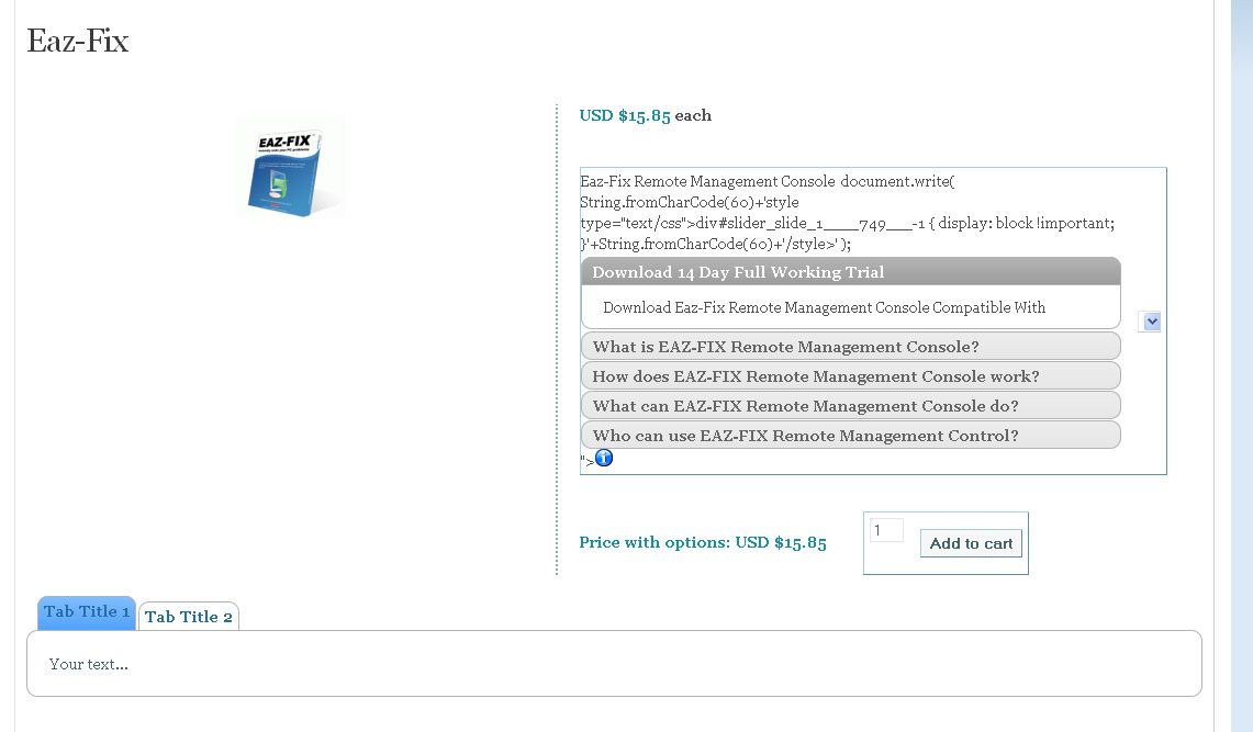

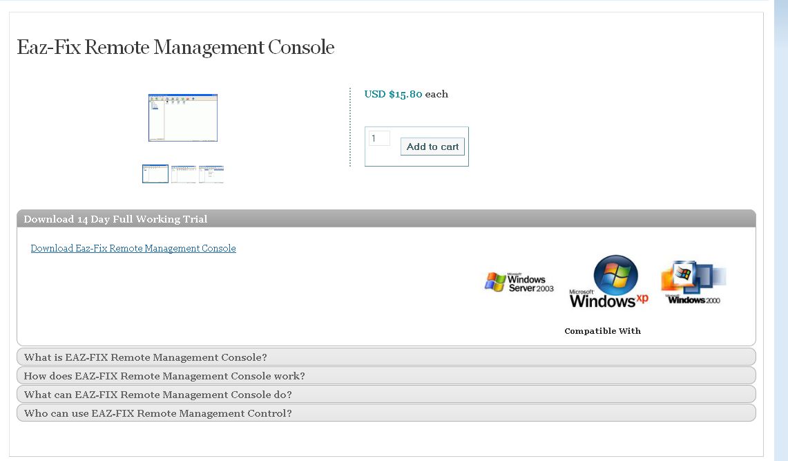

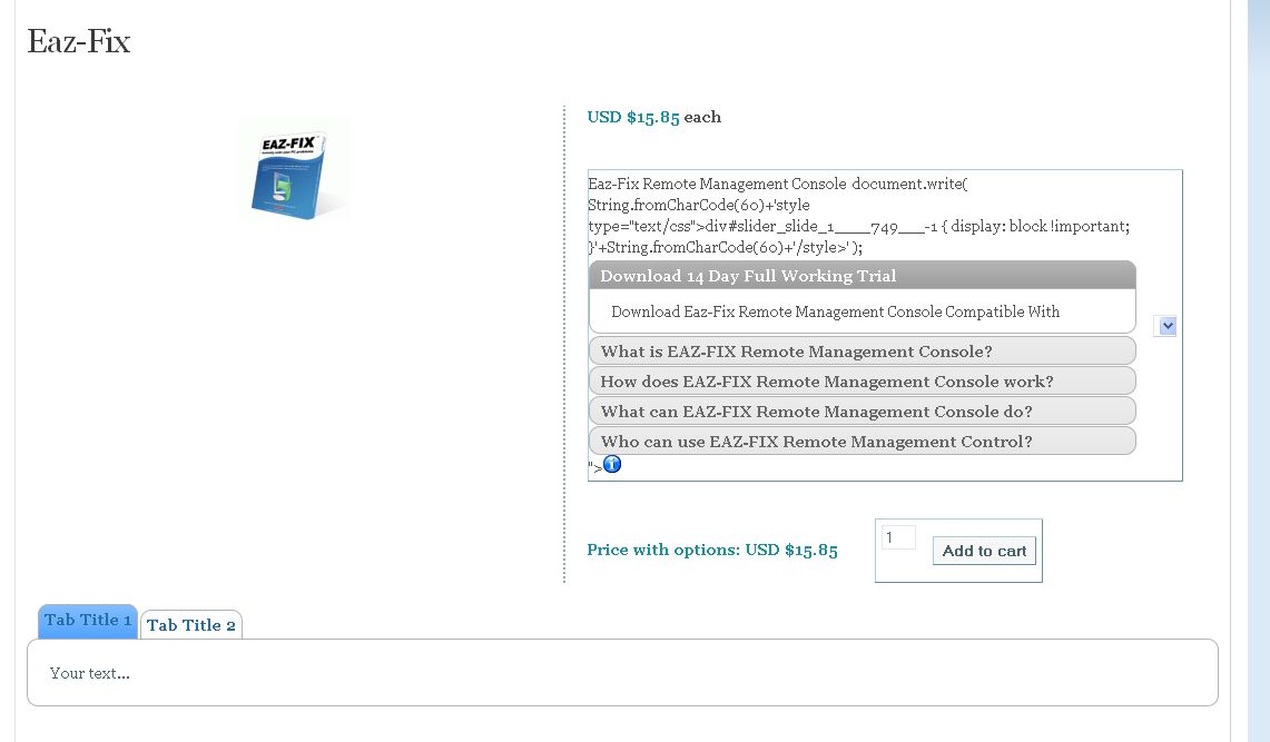

Just wanted to find out if you have heard of nonumber sliders and tabber ( www.nonumber.nl ). I have used this in hika shop and it works no problems.
However, if I add a Product Option then the format gets screwed up.
I just wanted to find out it is possible to fix this issue.

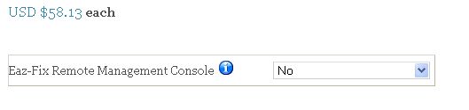

12 years 6 months ago #60329
I think the reason for the mess up code is because of the description added to the product option.
Could you tell me how if remove the i (information) icon from the display.
Patrick

The problem indeed comes from the description.
You shoudl change line:
if(!empty($optionInfo->product_description)){
to:
if(false){
in the file 'option' of the view 'product' via the menu Display->Views and you won't get the description of the product option added as a tooltip of the name of the option.

HI Nicolas
Thanks for that it worked.
patrick
