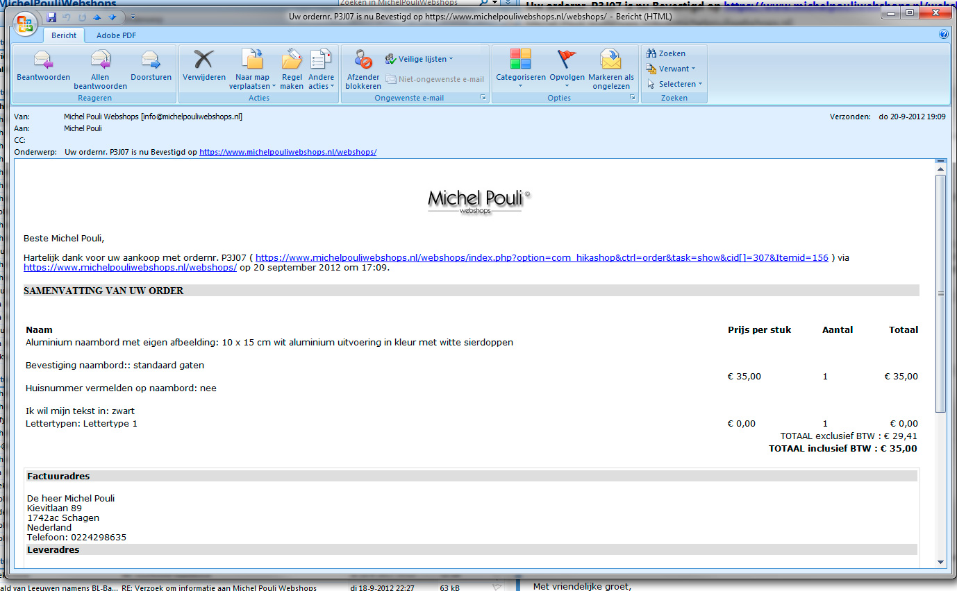

  • Posts: 515
  • Thank you received: 22
12 years 7 months ago #66553
By "activate the user notification in the back end", you mean to send an email after changing the status from the backend as administrator? Or is there a plugin besides the "attach" plugin that I need to activate? Here's the screenshot of the email.

12 years 7 months ago #66668
Yes, that's what I mean.
There is nothing to activate.
You have changed all your default order statuses and you missed something.
In the confirmed order status, you had an uppercase letter while the plugin will only send the invoice in the email with the order status "confirmed".
I've changed it to "confirmed" and it's working fine.

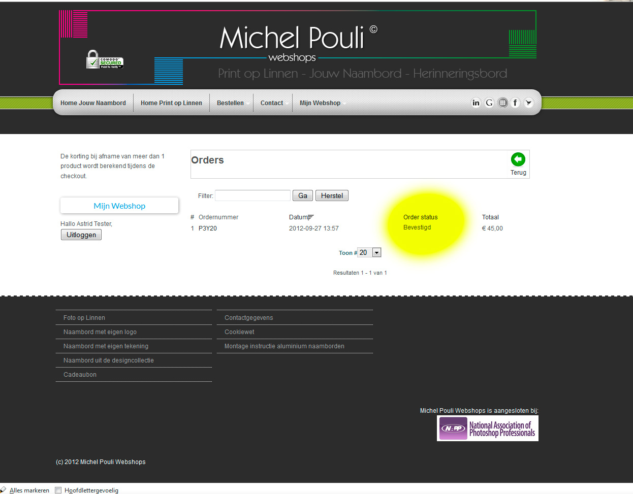

12 years 7 months ago #67586
The possibility for the client to pay afterwards in the order overview in the clientsurrounding (Login) is not working anymore... When I change the order status back from "confirmed" to "Confirmed", then it's working again. I suppose there's something I did wrong but I don't now what it is?
I (temporarely) solved this by changing the status in the attachinvoice.php.
Last edit: 12 years 7 months ago by jouwnaambord.nl.

12 years 7 months ago #67636
Yes, it must indeed be something that is caused by the fact that you changed the default order statuses.
I think that we'll lock the status name because it's really sensitive data and if you change it, it has to be changed in all the options of hikaShop and some stuff might not work properly.
Translation override is the way to go for such changes.
If you changed the plugin and it works for you then that's fine.
