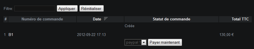

in Customer Panel / Command History
when commands are created and not payed, customers have the ability to go again to the payment site, clicking on the Payment button.
But why the payment available the listbox is "paypal1" ?
Could it be possible (and where ?) to name it just "Paypal" ?
Thanks.

12 years 5 months ago #66930
Hi codewarrior,
The name used in the dropdown is the name of your plugin.
You can change the name in HikaShop > Payment methods, rename the "paypal 1" plugin to, for example "PayPal" and it will be ok.
  • Posts: 190
12 years 4 months ago #68098
I'm sorry, but if I sent the post, it's because it's already named "PayPal".
I don't see another configuration element to change !
