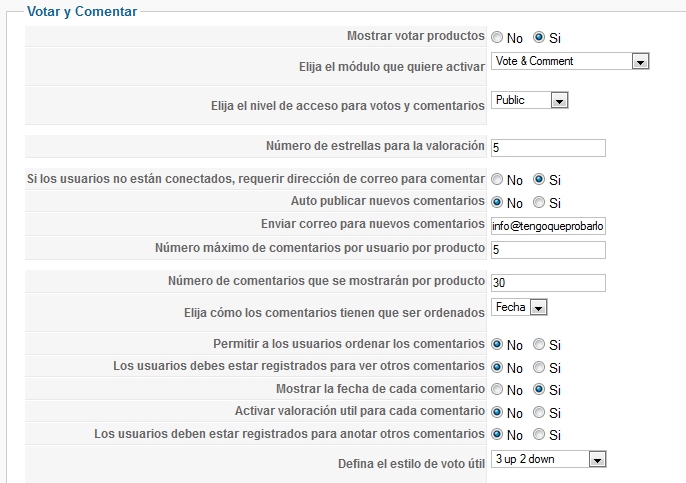

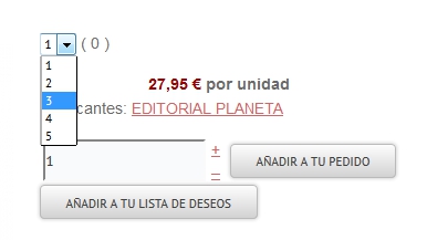

Hi, I have the same problem, I can not see the stars to rate. I upgraded to HikaShop Essential and I do not know if that was the problem or was the case before. I have seen now the problem ...
As you can see in the attached images in the product the stars come out, just get a drop down menu 1 to 5. But although the press, there is no voting.

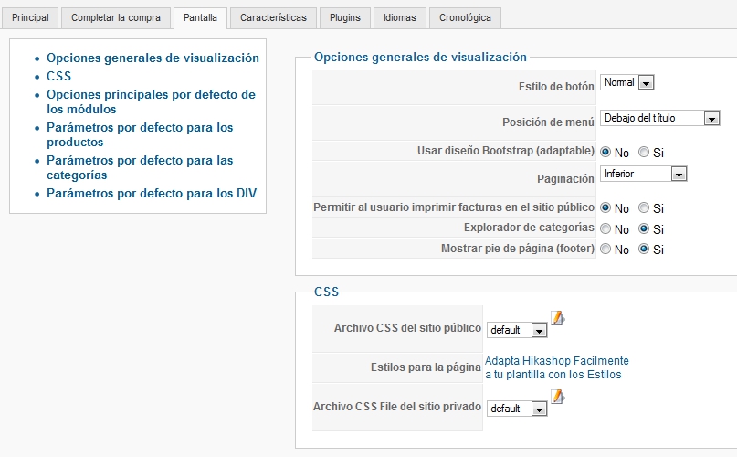

I think I have good Display>CSS Settings:
And also the configuration of Votes and Comments:
I have HikaShop Essential 2.1.3 and Joomla! 2.5.11. Thank you very much for your help. ;)
  • Posts: 26201
  • Thank you received: 4032
11 years 10 months ago #102307
If you do not have the stars and you see the dropdown, it means that you have some javascript errors in the product page.
The vote system uses javascript but if there are some errors in the page, the script for the vote could not be right initialized and could not work (be displayed) correctly.
