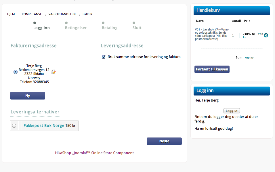

In the standard config the checkbox “use same address as billing address” is checked as a default.
How/where do you change this so that the default is that a shipping address has to be manually entered?

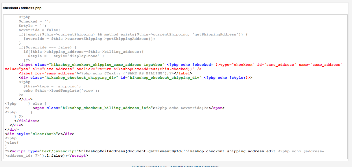

You will have to add such code at the end of the file "address" of the view "checkout" via the menu Display->Views:
?><script type="text/javascript">hikashopEditAddress(document.getElementById('hikashop_checkout_shipping_address_edit_<?php echo $address->address_id; ?>'),1,false);</script>
and remove the line:
$checked = 'checked="checked" ';

12 years 4 months ago #72515
Still checked …

12 years 4 months ago #72774
Please make sure that you're editing the view file for the front end template you're using and not another template or you won't see any change.
