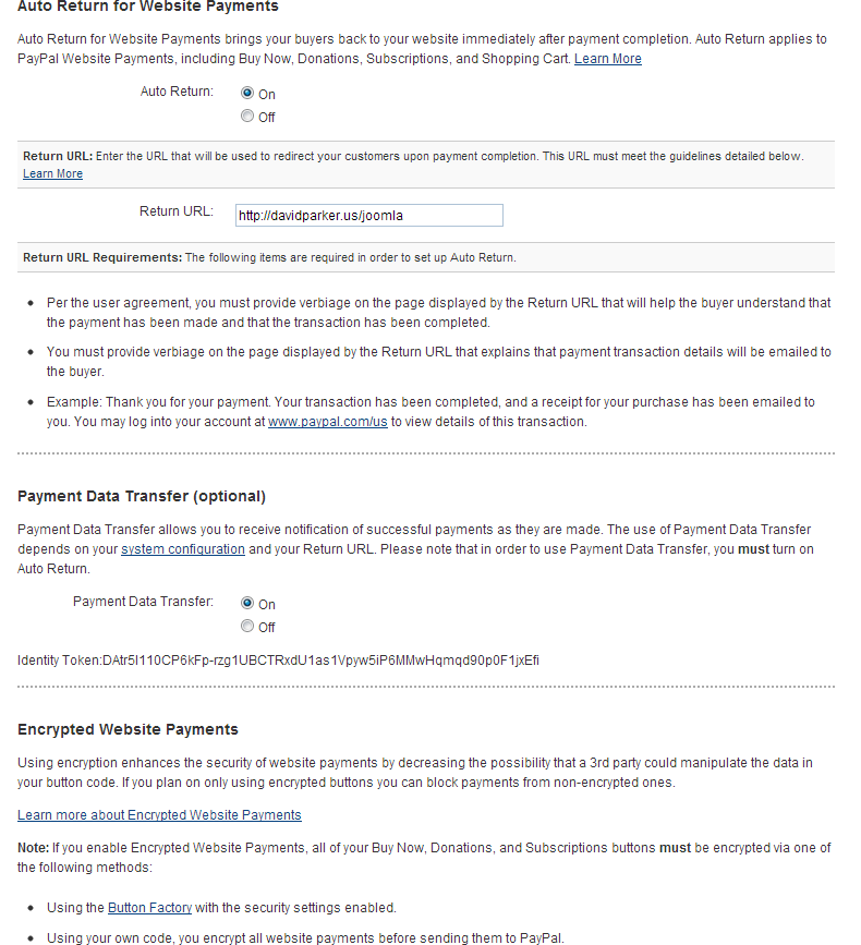

Got confirmation working, this was due to incorrect url in paypal account.
Now the subscription show in akeebasubs.
Still get nothing under Show Your Subscriptions.
Paypal is not processing the payment as a recurring payment.

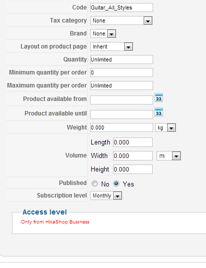

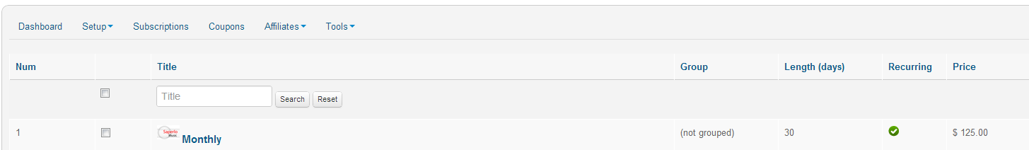

Hi Parker,
Are you sure that the subscription level is recurring ? And the subscription set to the product in the product edition page is the recurring one ?

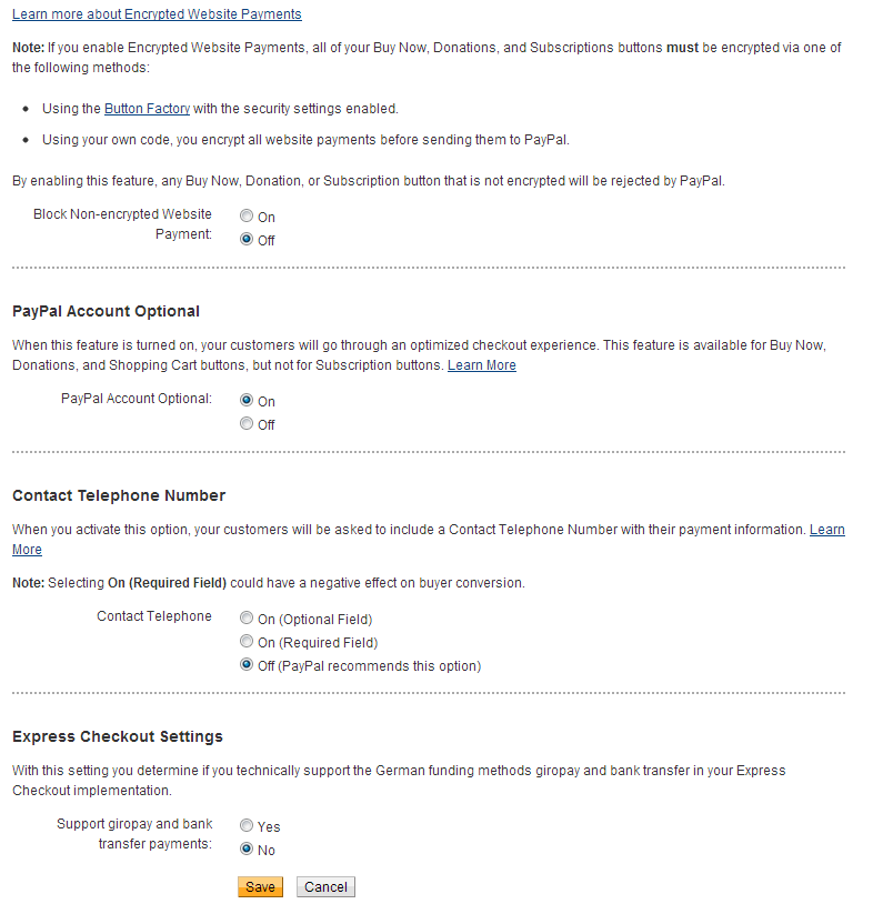

  • Posts: 48
12 years 5 months ago #75396

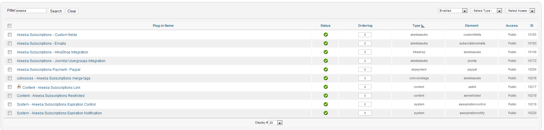

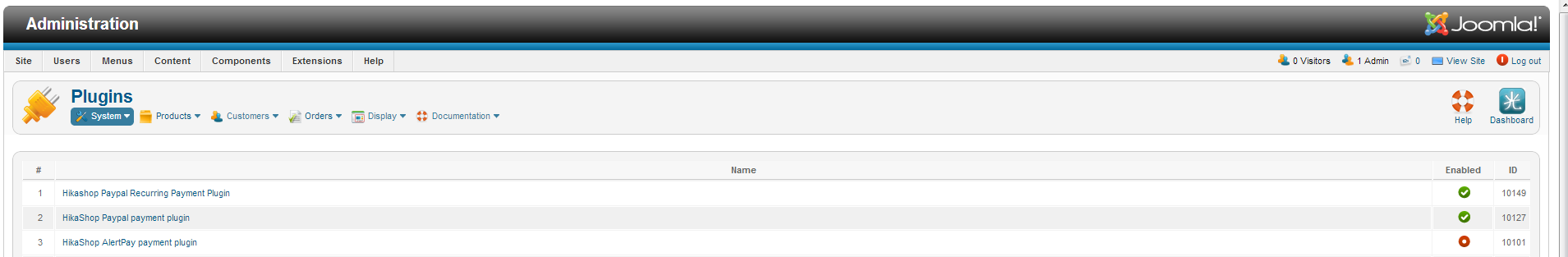

Here's my setup:
Akeeba Subscriptions - HikaShop Integration -active
Hikashop Paypal Recurring Payment Plugin -active
HikaShop Paypal payment plugin -active
Subscription levels are created and set for "recurring".
Hikashop product is set with the correct subscription
Here are the paypal settings:
By the way, paypal is not redirecting back to the site when a credit card is used. I get a redirect link, but automatic redirection is not working.
However, it does a full redirect if I pay with paypal. This is live payment, not sand box.
Thanks for your help, David
  • Posts: 83674
  • Thank you received: 13545
12 years 5 months ago #75693
The screenshots you made sound ok to me.
Did you set your account email in each of the PayPal payment plugins ?
If you can't figure it out, please send an access to your backend to Xavier via PM so that he can check your settings.

  • Posts: 26226
  • Thank you received: 4035
12 years 3 months ago #83873
Just the paypal recurring one.
