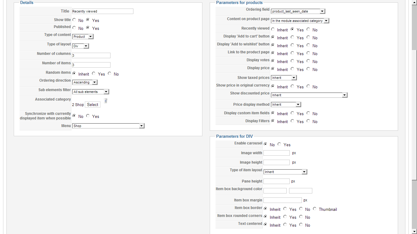

2. Can you show me a screenshot of your module ?

Hmm, I just deleted the recently viewed module, as I couldn't get it working properly. I created a new one and I can get it to display as a module, but not under the product page. Here's the link to my site commuter-hub.com/comhub .
As I said, I deleted the module so I can't give you a screenshot, but I can give you a screenshot of the one I just made...

I think that the problem could be that you restricted your module to only display on some menus with the "menu assignment" option of the module and that your product pages display via another menu that the ones selected for it.

Thanks. I've got it looking right. Now, did you have any advice regarding the first question? I still can't get that small image div to display when i have images linked to variants. Take a look at the Defeet Neon Dura Glove for an example. Many thanks.
