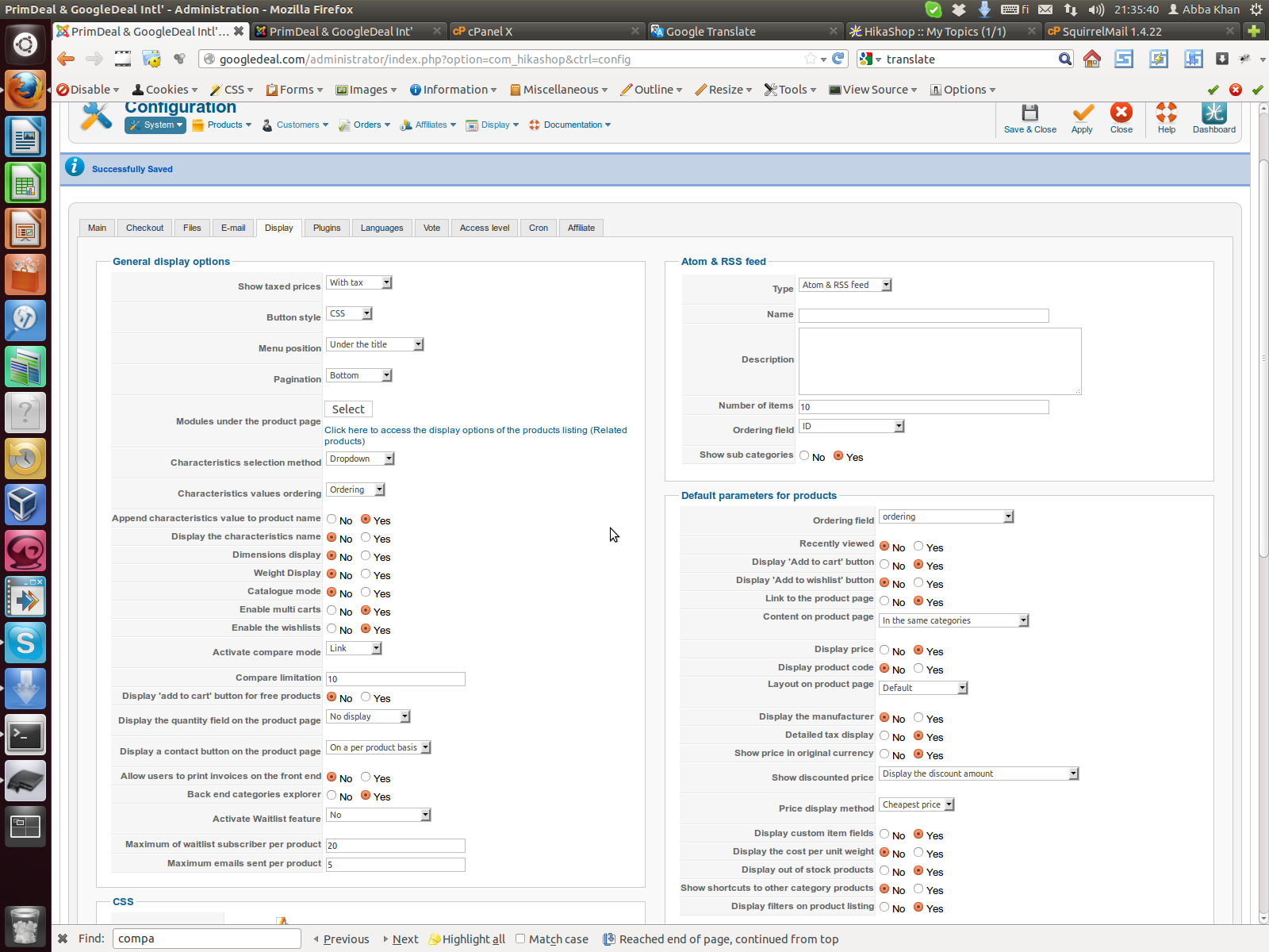

Both of my Wishlist and Compare mode is on. Wishlist button shows normally but when I click it I get the following error:
"An error occurred"
The "Add to compare list" button does not appear at all!
You can see here:
googledeal.com/fi/categories/14-pariisi-ranska.html
Settings can ve viewed from the file I have attached.

For "Compare list" I do not find any settings other than following 2 settings in "System->Display":
Activate compare mode (My selected value is "link")
Compare limitation (My value is 10)
I have checked:
1. System->Plugins
2. Display->Content menus
3. Display->Content modules
AND also other setting pages and tabs, but could not find any setting option(s) for "Compare list". The fact is the Compare button was being viewed for a while after I did make the above mentioned 2 settings (in bold), but suddenly it just disappeared.
About Wishlist, by activating the debug mode of Joomla!, I could not detect any new errors, a white window appears with the error: "An error occurred", nothing new. :(
Moreover, when a product contains Option(s), "Choose options" button is visible correctly but the "Add to wishlist" button disappears.
Sorry, I did deactivate the Wishlist as it was producing error. I have reactivated the module so you can try it.

As you can see with this link : googledeal.com/fi/?option=com_hikashop&c...&task=listing&cid=14
The compare mode and the add to whishlist are enable in your website.
It use a generic product listing without using menu options.
After that you can check the page : googledeal.com/fi/products/14-pariisi-ranska.html
You can see in the page a div with the id "hikashop_module_167".
It means that if you edit the HikaShop module with id 167, you would find the options for this listing (display add to cart, display wishlist, etc).
In the page you would find a div (parent to the previous) with the id "hikashop_category_information_menu_738".
As previous but this time with an HikaShop menu, you would find the options for this menu.
Your page is a compilation of default option, with menu options and module options.
