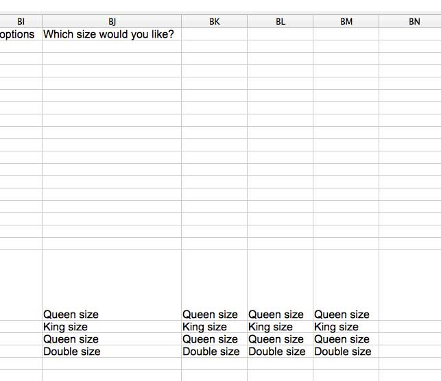

This is the exported csv of all of my products.
File Attachment:
File Name: hikashopexport2.csv
File Size:28 KB
The variant headers are messed up, e.g. variant "which colour would you like?" doesn't have the colours in the column. it has sizes instead.
Is it because the variant header as 5 words?
Also, some of the variants don't have headers at all.
I'm sure this is something simple but i can't work it out,
After troubleshooting I found that If I export a product and Import the file without changing anything, the characteristics no longer exist. I guess that rules out any problems with calc, so I'm guessing it's a problem in either joomla or hs.
After Importing the unchanged exported product list The product page says "no value found" where the characteristic option usually is.
Any clues?
Last edit: 12 years 2 months ago by karlvann. Reason: new info
  • Posts: 37
12 years 2 months ago #80929
It appears my problem comes from having variants with the same name.
  • Posts: 83326
  • Thank you received: 13473
12 years 2 months ago #81074
Ah yes, that would be a problem. You should try to use the alias of the characteristics to differentiate them.
