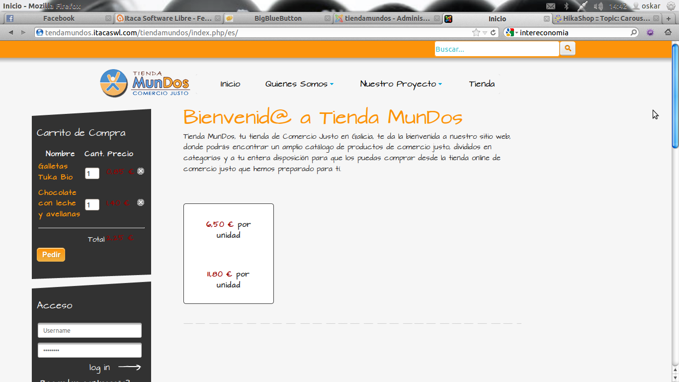

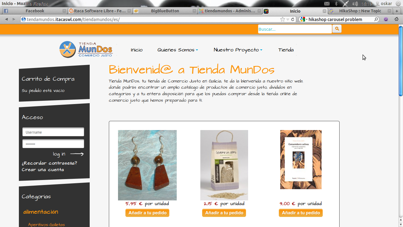

Hi i have a problem with the carousel.
Sometimes dont work fine ...
Please help me.
To see the error, attach 2 pictures one working fine and another working wrong.

The problem is not solved. The problem is that sometimes carousel not work fine

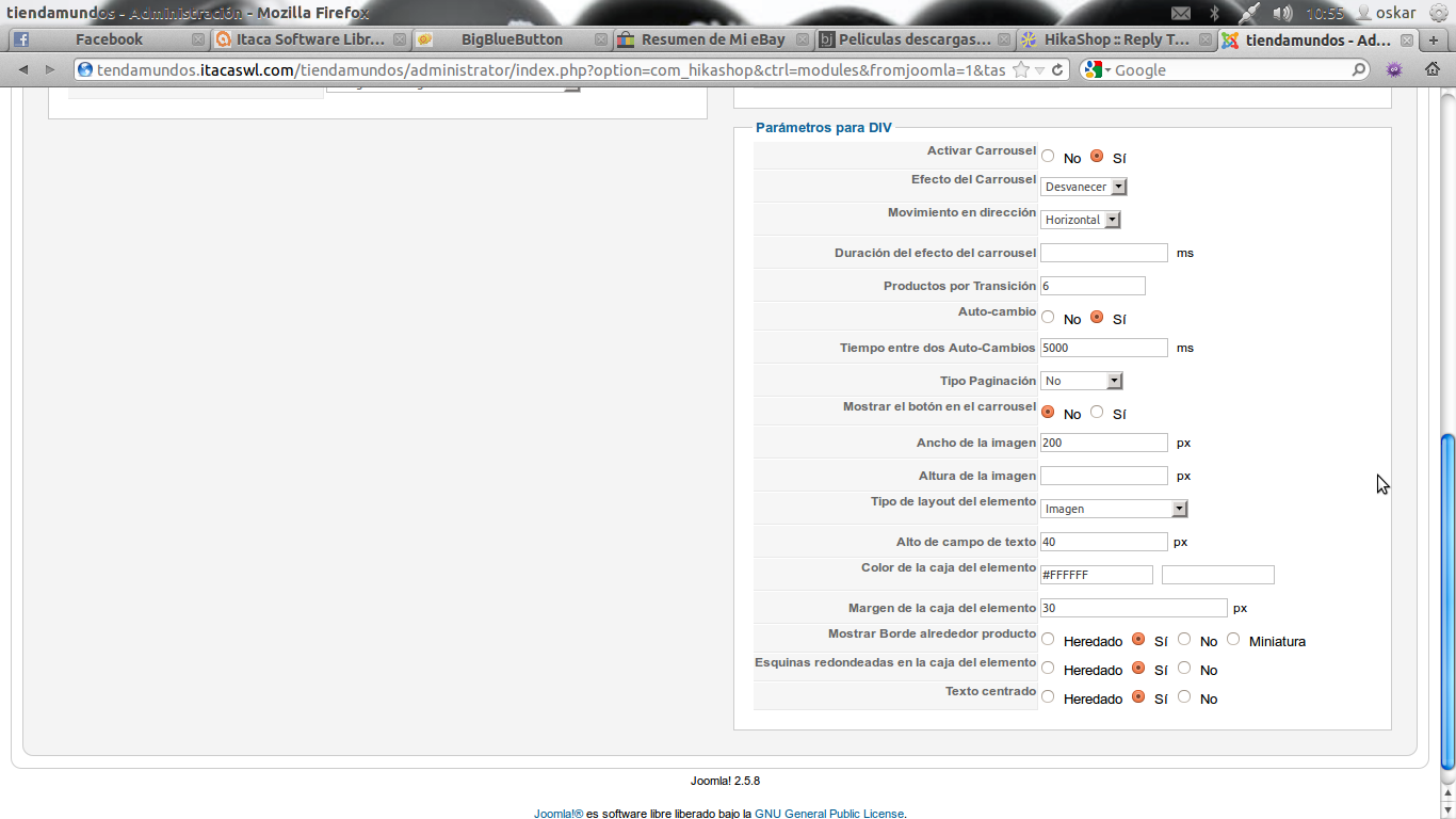

Could you give us a screenshot of you carousel configuration ?

Attach
screenshots of settings.

You parameters seems to be ok.

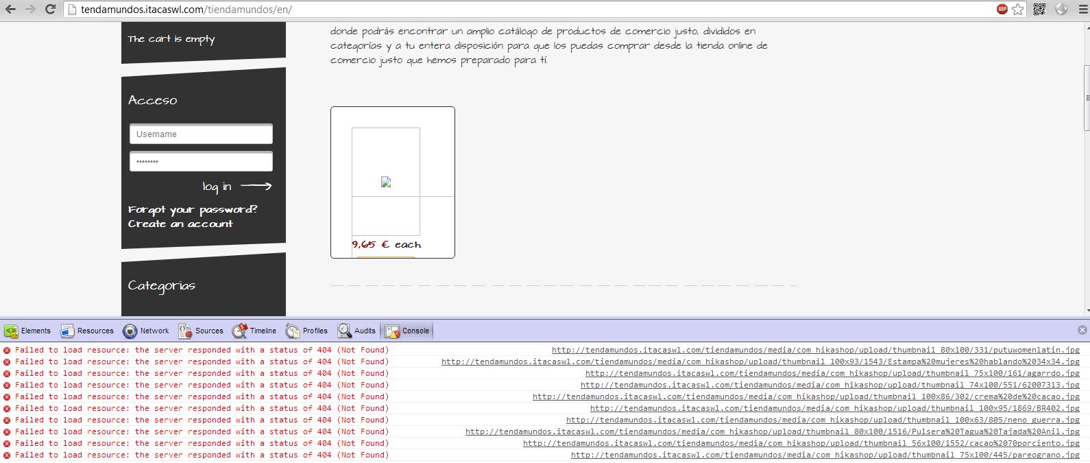

12 years 2 months ago #81761
I have see two times the problem by making several refreshs and the carousel does not really crash.
When I had the errors, a lot of images where "404 error" in the carousel. So I think that the missing images broke the carousel script.

12 years 2 months ago #81898
Thanks.
I think that the problem is solved.
Filling the value of widht and height , the carousel works fine .
In my configuration the value heigh was empty.
