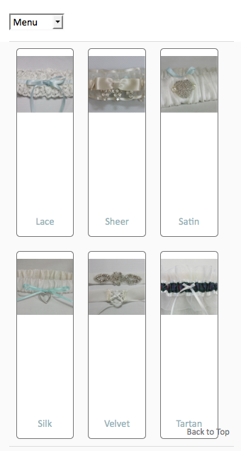

I'm trying to make my Hikashop product images behave with my responsive template but I understand that HS 2.0 is not yet fully responsive? In case it helps someone else, I have solved a couple of problems but still have one I need help with please.
I fixed the problem of the product display page right part being overlapped by my main product image in the left part by forcing the right part onto a separate line for screens below a certain size. I inserted this code in the frontend CSS and now the product options and add to cart button etc move underneath the main image, which looks OK:
@media only screen and (max-width: 640px) {
.hikashop_product_left_part{
width:100%
On my category product listing pages my thumbnail images were expanding out of their containers and overlapping each other at smaller screen sizes because I had increased the general thumbnail size to 175px in the configuration display. So this is not really a fix but I solved my issue by reverting back to thumbnails of 100px.
My remaining problem is that on my main category pages I want the image thumbnail sizes to be bigger at 200px (there are six categories currently displayed in 3 columns 2 rows). However, in smaller screen sizes, although the photos get smaller, the image containers have a big white space between the photo and the bottom bottom of the container box (see attached). It would maybe be OK if I could force the display for mobile screens to show just 2 columns instead of 3? Can anyone tell me the code to make that happen please? Or offer an alternative solution to remove the white space just on these pages?
Thanks!

We introduced in HikaShop 2.0 some responsive rules in order to be compatible with the new philosophy of Joomla 3.0
We made some tests of our views for classical uses.
The product listing use the image thumbnail height in the div. It means that 175px would be allocate for the image height.
But the responsive listing would automatically resize the image because there is too few width. So, it generates the blank height.
If you removed the forced height, at this moment, your cells could not have the same size (if your images does not have the same ratio). It could break your design.
The idea could be to change screen rules, in order to switch from the columns mode to the row mode before the "smartphone" size.

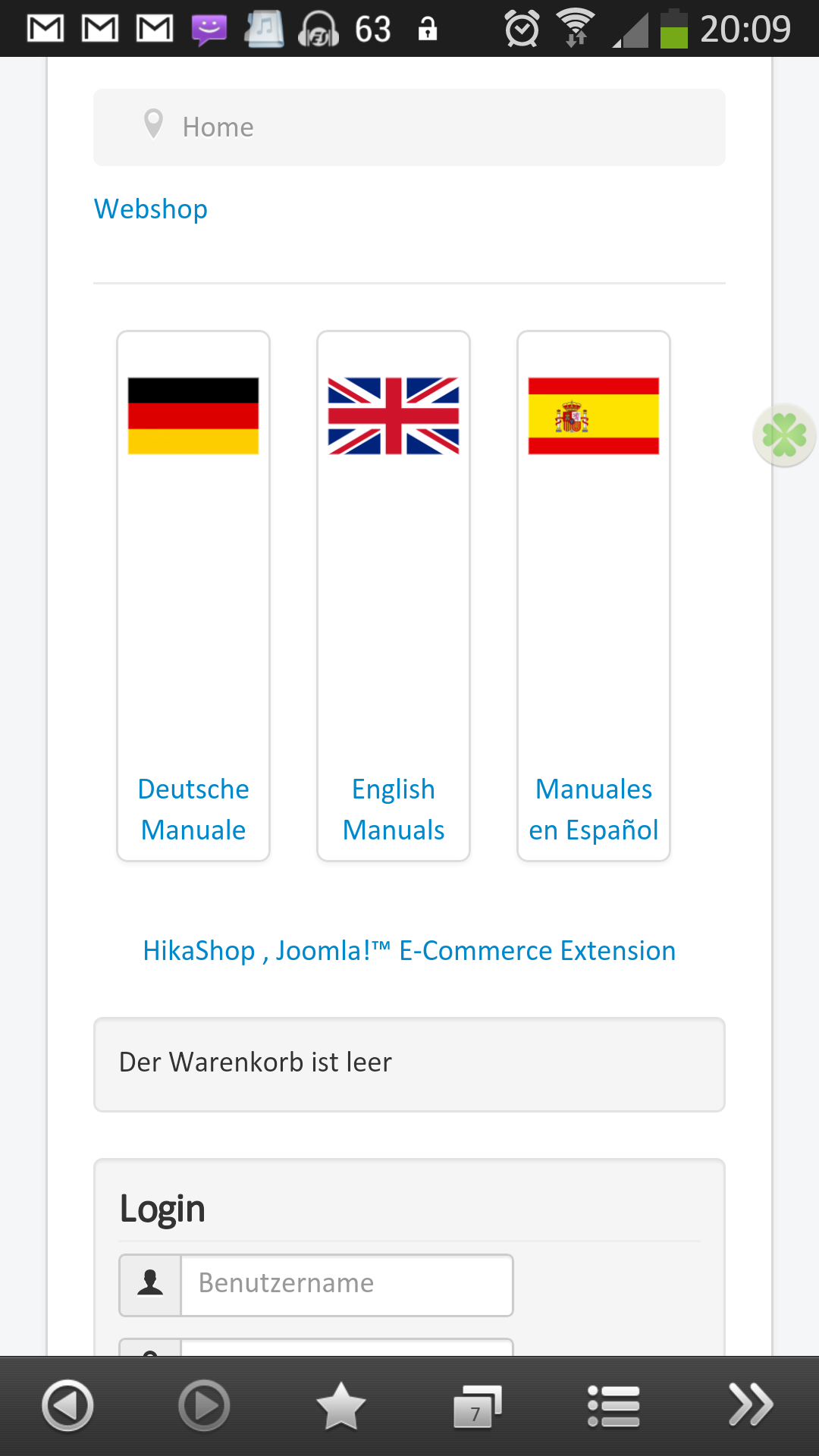

Hi!
I have the same problem, but the solution doesn't work for me. I inserted the code into frontend_custom.css, but nothing happens.
Could you tell me, how to fix the img width exactly? I have 170px pictures both for categories and products.
I attached 2 pics. First is showing the problem, huge space below category/product-images.

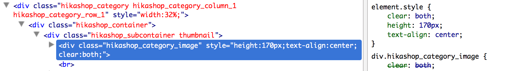

Second shows the code. If I change the "170px" with Firebug to "auto", everything works fine, also in smartphone-size!
So the only question is: how can I change this permanently? The 170px are produced via php-file in "/components/com_hikashop/views/category/tmpl/"
Where can I cange the fixed height into a simple "auto"?
Thanks, Michael

Look at the CSS code proposed by mhunter:
#hikashop_category_information_menu_132 div.hikashop_category, #hikashop_category_information_module_112 div.hikashop_category {
width: 100% !important;
That code will only apply to the hikashop_category div if the id of the module displaying it is 112. So you need to change the id in the CSS if you want it to apply to your module/menu.
Regarding the height, you can always override it with the !important CSS trick like that:
hikashop_category_image{ height: auto! important; }
The following user(s) said Thank You: mandrael
