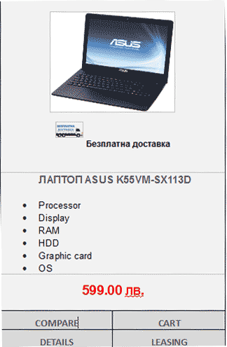

Happy new year 2013
I have question, it's possible to make such layout in category /see picture for example/
I mean to add a couple buttons in the bottom part to container ?
Regards, Djuni

12 years 1 month ago #84058
Everything is possible if you code it... You can add your buttons in the file "listing_img_title" via the menu Display->Views.

12 years 1 month ago #84072
Thanks, Nikolas :)
Мy knowledge is not so great :blush: , can you give me some more help to do it :) Until now you have always been responsive to thank you from the heart :)

12 years 1 month ago #84357
Hi Djundi,
Since we have a lot of support we cannot really spend time to make customization for our client.
If you really want something special, just ask on the Commercial Jobs forum and try to find someone good enough to help you.
However, I can give you this tip:
The different elements of the layout have been tagged so you can know immediately which part of the code is doing what. Try to move these blocks to see how it affects the layout.
The rest is just about some css customizations and rules added to the front end css file :)
