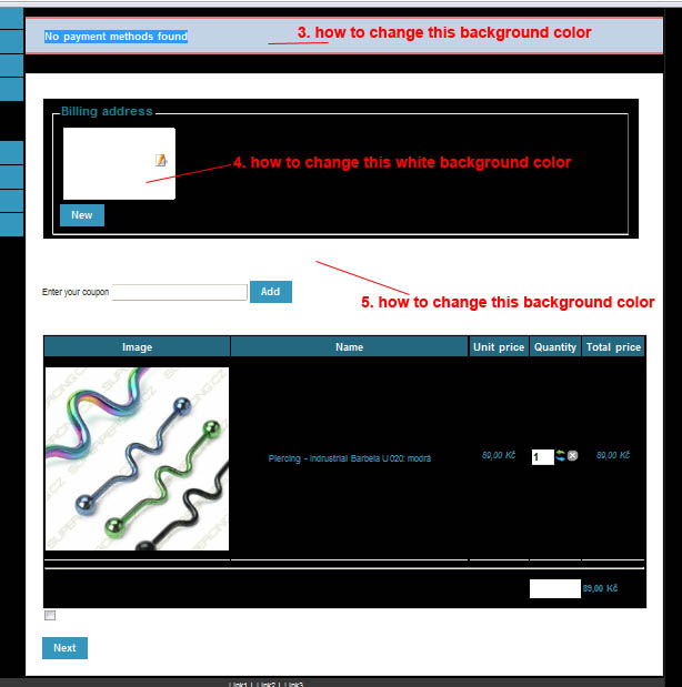

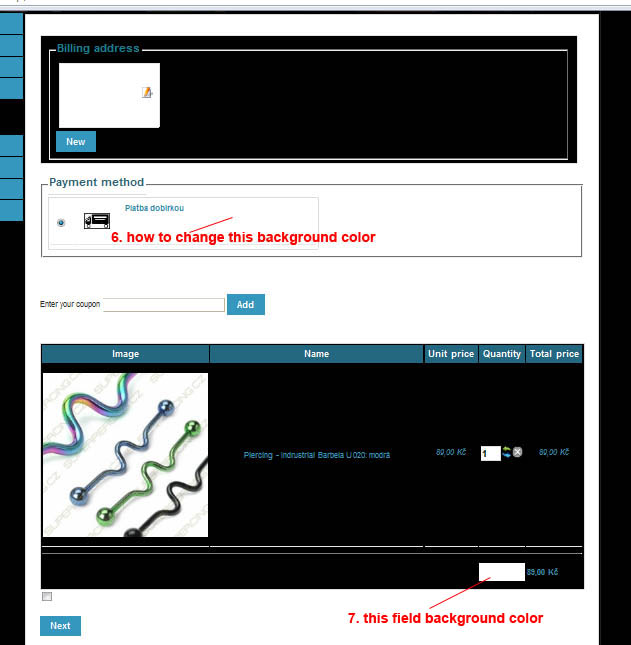

could you please help me with changing some colors in the pictureblue template? See attached files for details.

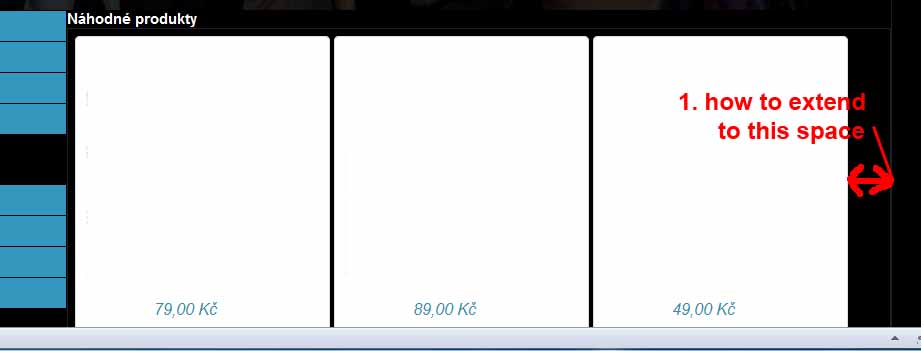

1. I have a wider template than Hikashop 3 products in row is. How can I make the products list wider to fit my template width?
2. Where can I change the color of the link in Hikashop cart?
3. Where to change the color of the background of the "No payment methods found" message?
4. Where to change the background color of Billing address field?
5. Where to change the background color of the checkout field.
6 Where to change the background color of Payment method field?
7. Where to change the background color of the field with total in checkout screen?

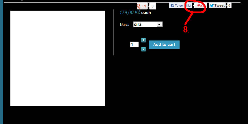

8. Why is the facebook likes count icon hidden behind the Pin it icon?

thanks for your reply. I have changed many styles in that template but these are the ones I cant find where to change.
I dont want to bother you so could you please help me with only these at least?:
1.
4.
5.
6.
7.
I would really appreciate your help.

1. Theoretically the rows should use whole space, try to look with firebug if there is anything in this space, maybe an empty you forgot to delete
2-3-4-5-6-7. Actually for these question you always have to follow the same process. Let's take an example with your second question. Do a Right click on the link and open firebug (or "examinate this page") to look at the class which include the link. You'll see it's hikashop_cart_module_product_name_value hikashop_cart_value . Then edit your frondend css in System>Configuration>Display. In this case you'll have to add something like:
.hikashop_cart_module_product_name_value hikashop_cart_value a{
  color:red;
the "a" added at the end of the class specify the element on which your rule will be added, in this case, the links.
Just try it by yourself for your other question. If you really can't achieve what you're looking for, I'll help you but you may understand that we don't have that much time do that kind css customization.
8 - Try to update, we have changed few things in the social plugin and it may solve the problem :).
