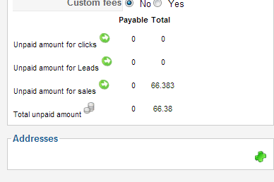

Hi!
I'm trying to pay my affiliates, and even though it says they have earned money, the total comes to $0 when I click on the pay now button, and it wont go through to PyaPal.
Thanks :)

Can you do screenshot of the problem ? Are you using the latest version ?

Hi!
I'm using the latest version, but the Joomla version needs updating. The installation is corrupted, so can't upgrade.
I have attached a screenshot for you.
I can always manually pay them, and then test for the problem once I have moved the site to a fresh Joomla install.
Thanks :)

Your screenshot says that the payable amount is 0. So it's normal that you can't pay the user.
It means that the sales that you got are not old enough for the option "Minimum delay before paying the affiliate commission" that you set in the Affiliate tab of the configuration so the system dismiss them for now until that period has passed.

Of course! Sorry :/
