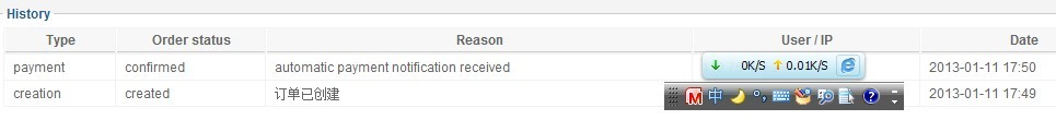

Was the order confirmed in HikaShop ?
  • Posts: 94
12 years 3 months ago #85895
Yes!The order was Confirmed!

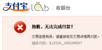

I couldn't test the error because I didn't use direct mode alipay plugin. I only could use partner mode alipay plugin.
My error code is Illegal_argument. The Alipay technical said it was bec
  • Posts: 94
9 years 3 months ago #225275
Hi Mohamed Thelji:
My error code is Illegal_argument. The Alipay technical said it was because the request parameters is not enough.
Please check the " 4.2.2 list of parameters "chapter in attached file Escrow_Payment_API_Specification(create_partner_trade_by_buyer). All parameters marked with "N" in the list should be used.
Do you need the old code "plg_hikashoppayment_alipay" file which you sent to me two years ago?
Last edit: 9 years 3 months ago by bluetooth.
9 years 3 months ago #225286
Ok thank you for the documentation, the current Alipay payment plugin will only works with the direct mode of the moment, and we added the partner mode to our TODO list for the moment.
