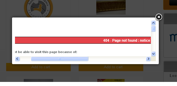

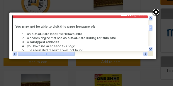

I am facing problem with add to cart button.
I have already set all the setting proper
But when i click on add to cart button, that time pop is appear and give 404 error.
is there any solution for solving this bug. Please see the screenshot which i have attached.

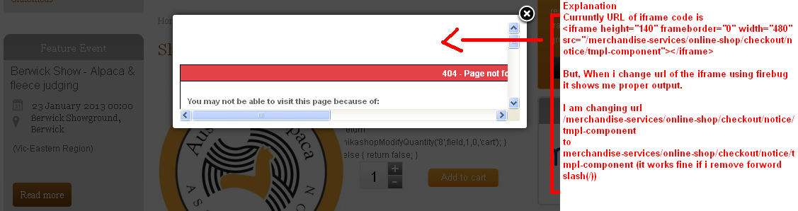

let me explain visually.
Please Kindly check my attached image

I FOUND PROBLEM
11 years 11 months ago #86711
And did you solve it ? :).
  • Posts: 12
11 years 11 months ago #86713
I just found problem.
there is a problem with url rewriting. when url rewrting is on that time it gives me error.
otherwise it working fine.
