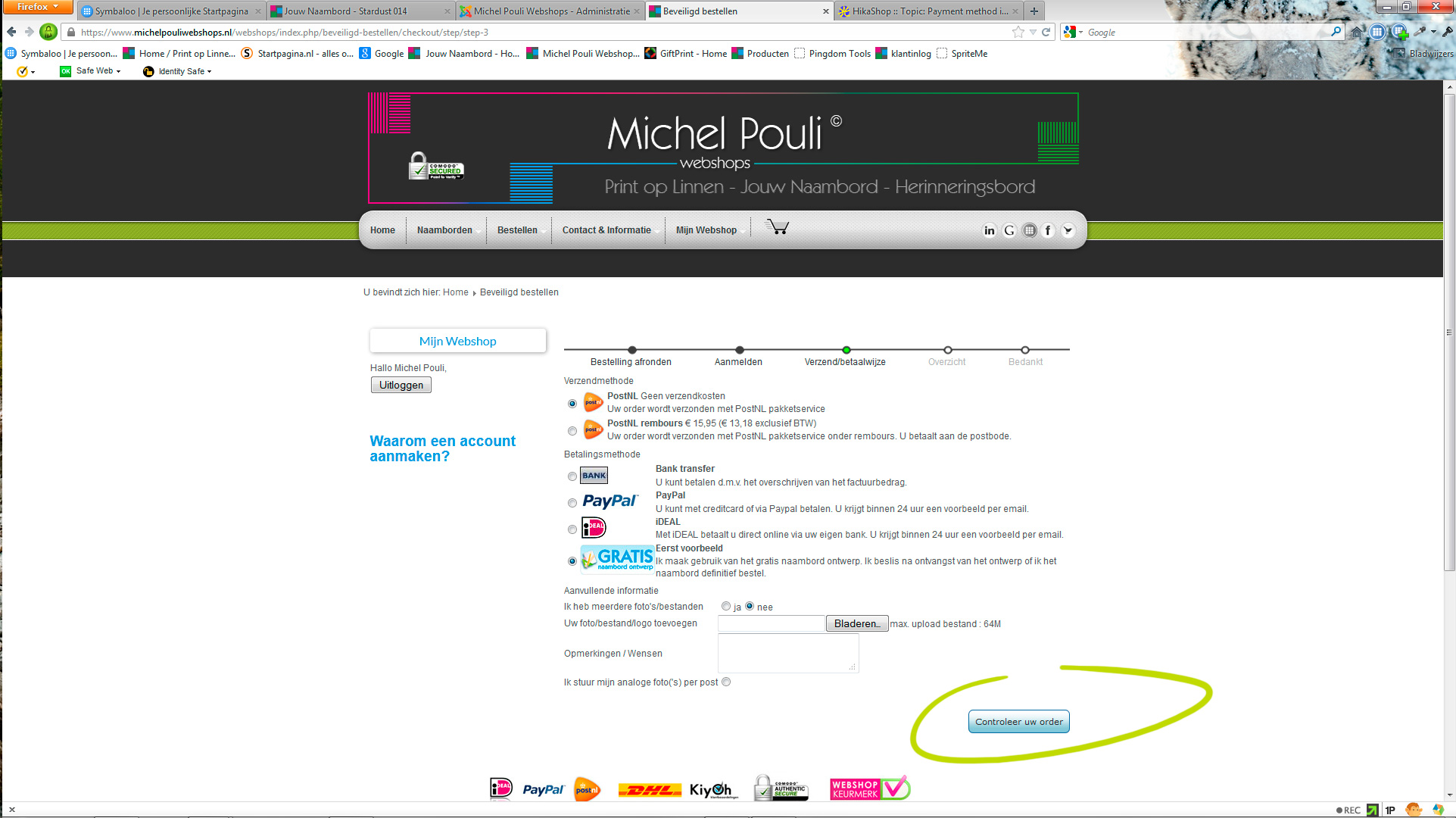

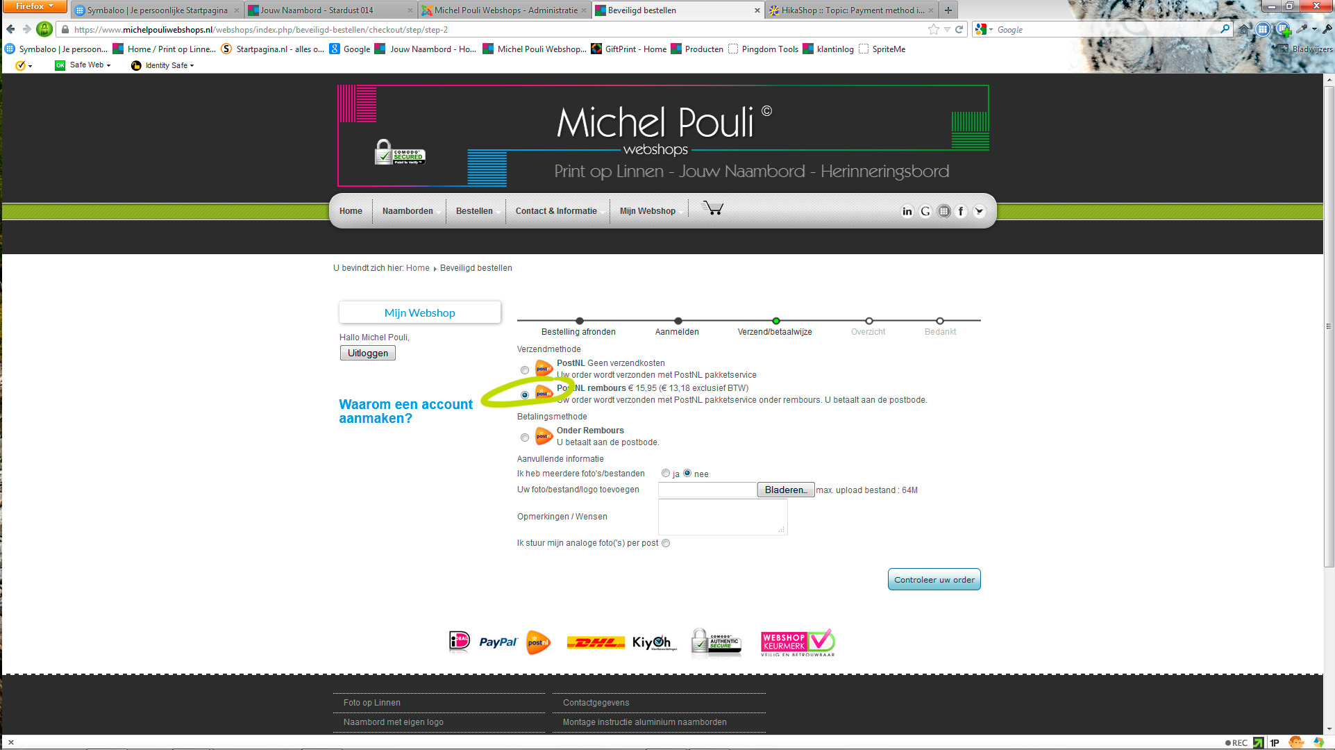

I do think stiil this should be possible. When I check the shipmentmethod "PostNL Rembours" and hit the next button, the paymentmethod is not displayd and the next page is shown. But when I go 1 step back in the orderproces, you will see the right payment method (not checked, but indeed shown, see screenshot 1). Then when I choose the shipment method "PostNL" and hit the next button, the page refreshes and this time do show the corresponding paymentmethods! (screenshot 2). So why doesn't this happen when I choose the "PostNL Rembours"??
Michel

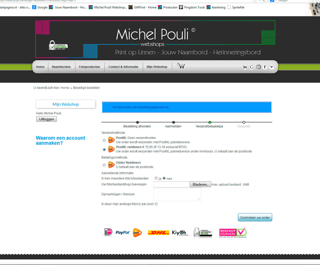

11 years 11 months ago #89090
Well, partially it did. But when you choose a shippingmethod, a warning "fill in your payment details" is displayed before you can actually choose a paymentmethod.
