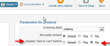

I successfully removed the "Add to cart" buttons on the Product Listing pages of a website by following your directions:
"Edit your product listing through "Hikashop->Display->Content menus->Your product listing" and set the "Display 'Add to cart' button" option to NO.
I have just installed Hikashop Essential on a new website and again need to remove the "Add to cart" buttons on the Product Listing pages but this time, your directions are not working and the buttons remain. How can I remove them?
Please see the attached screen print:

11 years 11 months ago #87611
You have to edit the menu "Galleries" then click on the link to the associated module.
In the associated module options, set "no" for the option "Display 'add to cart' button".

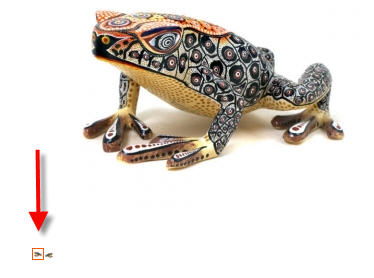

I have one last issue that I need to ask you about:
When I add multiple images for a product, they appear on the product description page as tiny "child" images below the original image. How can I make these child images larger?
Please view the attached screen print:
11 years 11 months ago #87922
In HikaShop > Configuration > Files, be sure that the thumbnail size is not to low.
Else you can use a CSS property to use larger images.

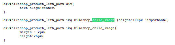

11 years 11 months ago #88069
Add this property in the css file:
.div#hikashop_product_left_part img.hikashop_child_image {height:100px !important;}

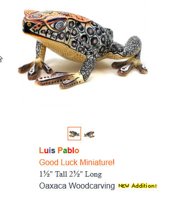

1) Before, when I added multiple images for a product, they appeared on the product description page as tiny "child" images below the original image. Following Xavier's instructions, I added this code to the front-end CSS file:
Now the child images are much too large. I need them to be about 1 inch wide.
Please view the child images at this link:
webserver22.com/carol/index.php/gallerie...ry-1a/product/3-frog
I changed the pixels in the code first to 25 pixels, then to 10px but was not able to reduce the size of these images. How can I now make them smaller?

11 years 11 months ago #88509
1.
You're using the code:
.div#hikashop_product_left_part img.hikashop_child_image {height:10px !important;
That code is not valid. It should be:
div#hikashop_product_left_part img.hikashop_child_image {height:10px !important;}

For issue #1) I corrected the code as you instructed and reinserted it but it's still not working:
Once again, I need the 2 tiny child images below the large main image to each be about 1 inch wide.
Thank you for your patience and your help with this.

11 years 11 months ago #88695
I can see the thumbnails with the correct height of 100px on your website.
It must be the caching of your browser which prevents you from seeing the change.
Try with another browser and you should see that it already works.
