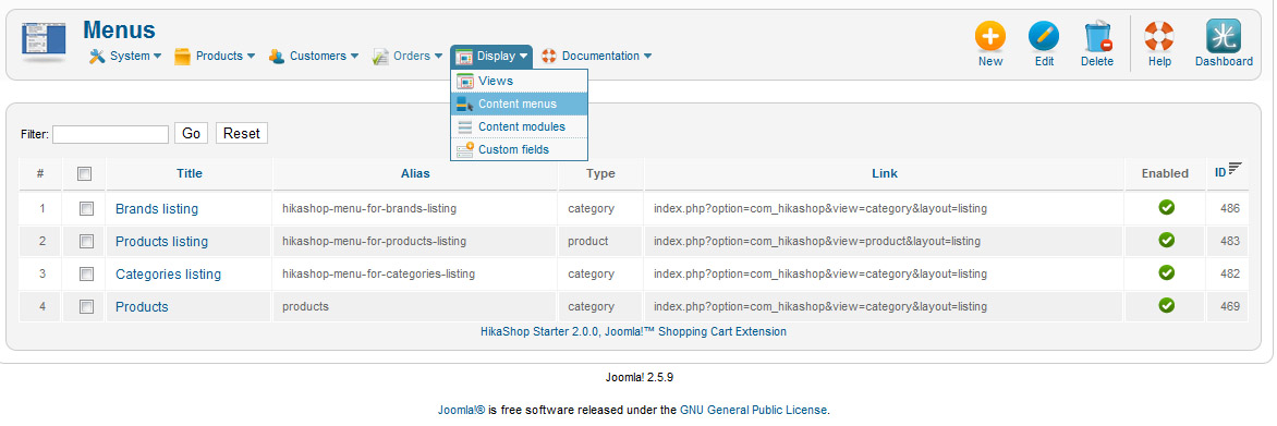

In content menus I have the following:
Brands listing
Products listing
Categories listing
Products
On each I've set "Sub elements filter" to "All sub elements" but no luck.

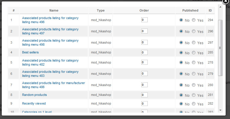

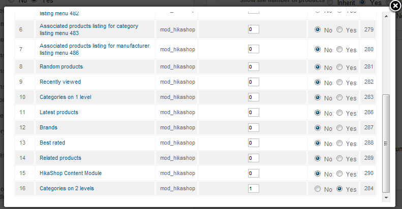

11 years 11 months ago #88645
Sorry, I'm still a bit lost on this :(
See attachments for screenshots on what comes up in associated modules
11 years 11 months ago #88757
To find the good associated module, you have to edit the menu products. (HikaShop > Display > Content MENU), then in the menu options click on the associated module (bottom left of the page).
And in the module options, set a menu on it.
  • Posts: 15
11 years 11 months ago #88773
Still not really following the logic, this is what comes up in content menu... So where do I go :dry:
11 years 11 months ago #88918
Now you go in "Products", then you should see a link "Click here to access the display options of the products listing (Associated products listing for category listing menu xxx)".
If you don't have the link, so click to generate automatically an associated module at the top of the page.
Then when you have clicked on the link "Click here to access the display options of the products listing (Associated products listing for category listing menu xxx)", here you can apply the changes for the products listing.
