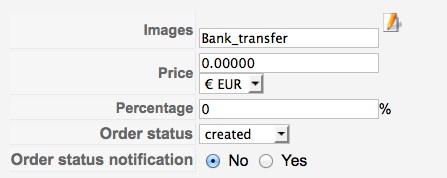

11 years 11 months ago #89154
is set to Created (see figure)
but the order is cleared from cart
regards

  • Posts: 83049
  • Thank you received: 13408
11 years 10 months ago #89346
If you want that the cart is cleared directly at the end of the checkout all the time, you can change the option "Clean cart when order is" to "created" in the Checkout tab of the configuration.

  • Posts: 83049
11 years 10 months ago #89631
If you set the option to "confirmed", the system will remove the cart when the order is confirmed. However, the bank transfer plugin itself removes the cart after the checkout as that's what you want all the time for offline payment methods like bank transfer.
The option should read like that: "Clean cart when order is" + "confirmed for online payment plugins and created for offline payment plugins". But that's a bit long for the dropdown...
