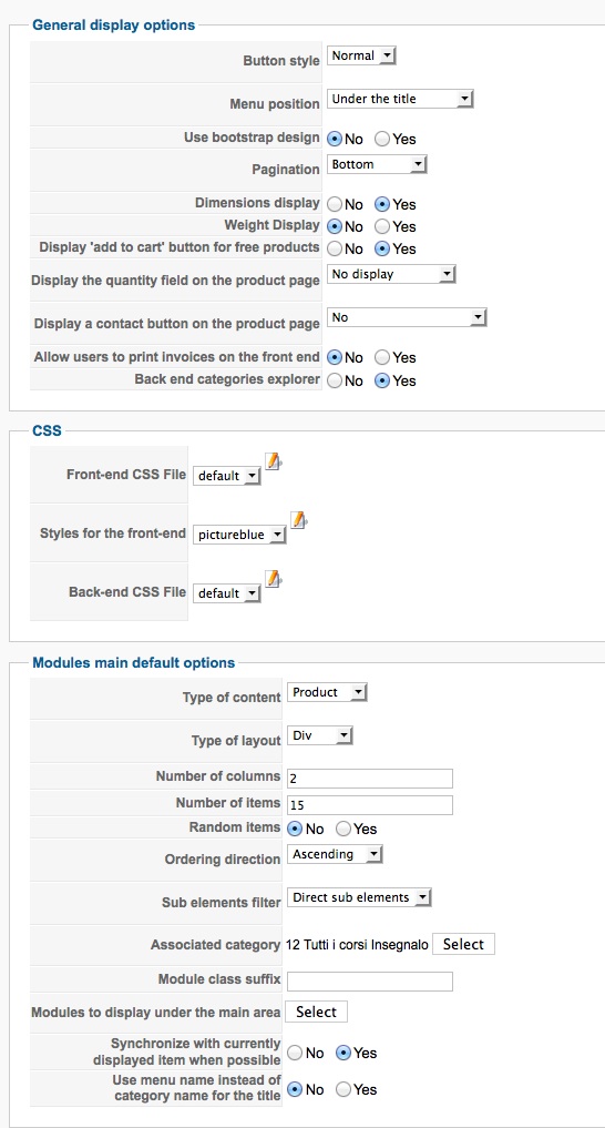

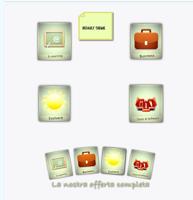

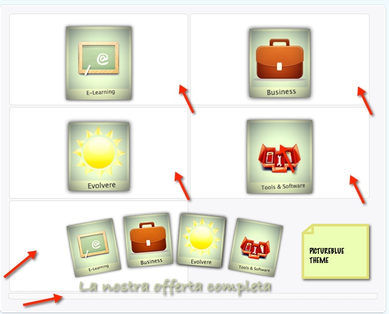

How do I remove the box around the icon of the categories?
With the same configuration, the box does not appear in the standard template
when I put the template is pictureblue instead!
I attach images!
thanks
Fabio

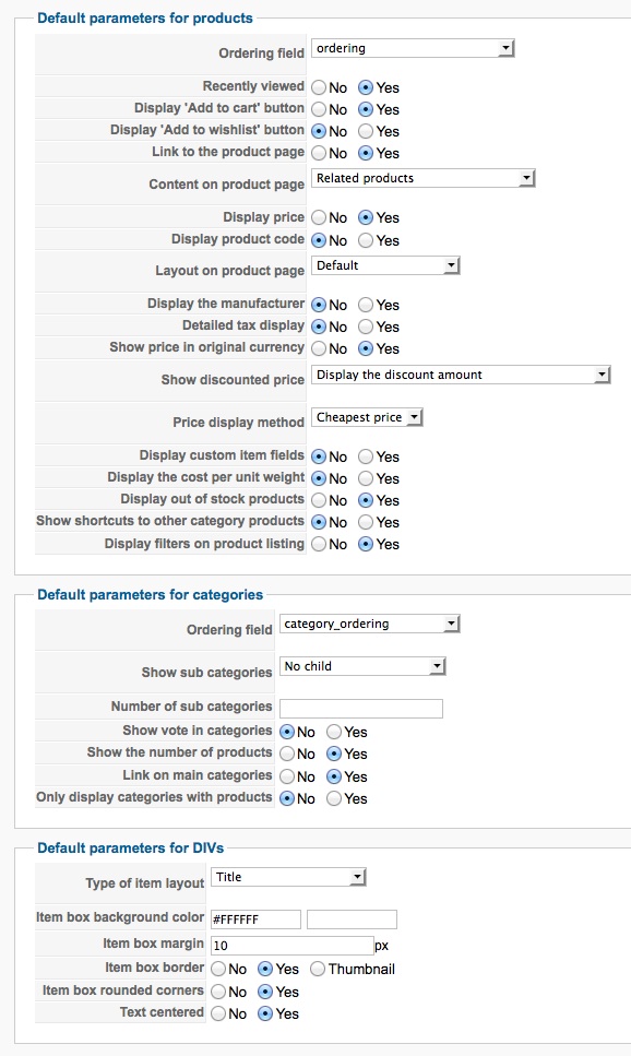

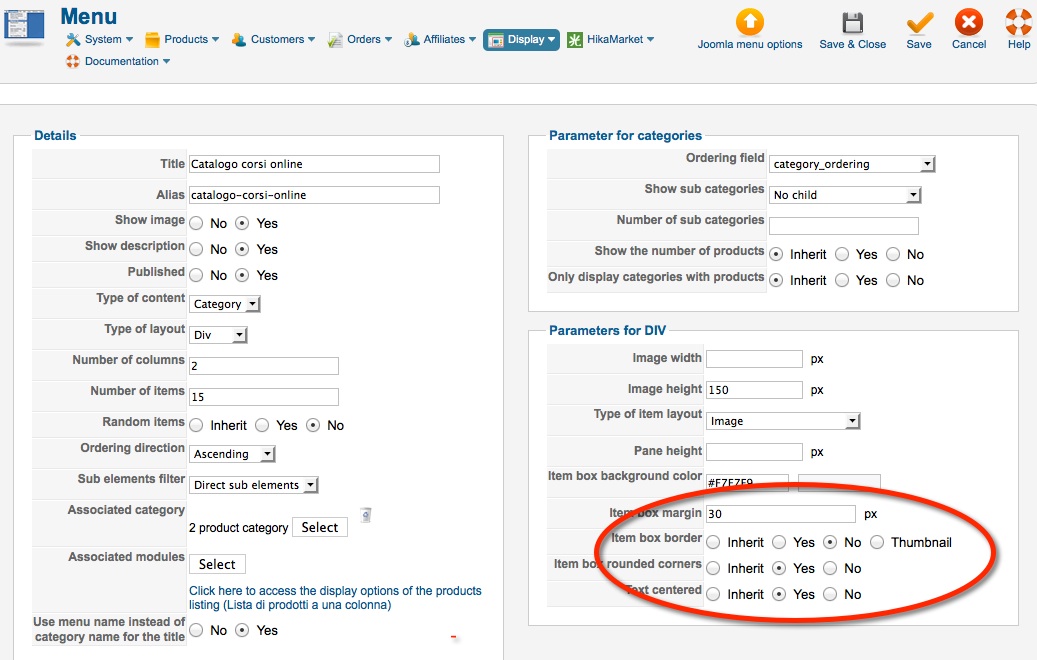

In each listing (that you can edit via the menu Display->Content menus/modules), there is an option "Item box border" which you can turn on or off for the listing.
  • Posts: 89
11 years 10 months ago #89469
Hi Nicolas
is already so!
I repeat that With the same configuration, the box does not appear in the standard template
when I put the template is pictureblue instead.
So it is an obvious problem of template!
look at the images attached to the first post
Fabio
