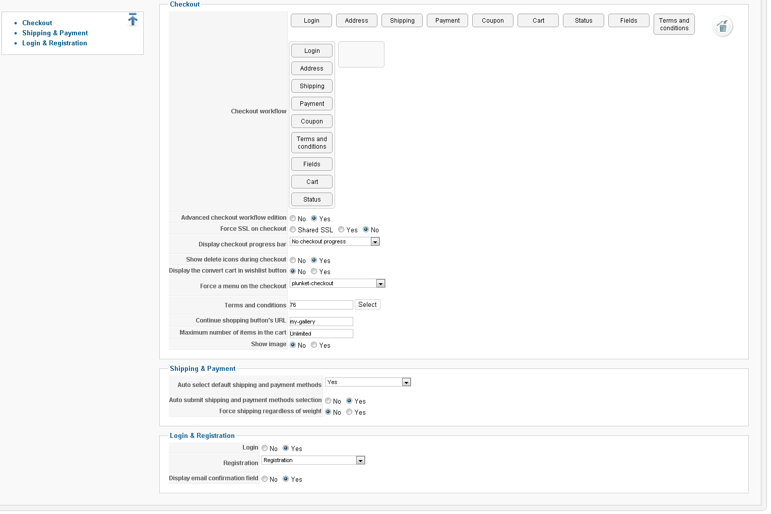

  • Posts: 23
11 years 10 months ago #91033
Hi, I've attached the checkout screen capture, Have sent a pm with logon details.
D
  • Posts: 26168
  • Thank you received: 4030
11 years 10 months ago #91153
Please deactivate the "advance checkout workflow" in order to check that you have the right "confirm" step.
If not, please redownload hikashop in order to fix the problem (you would have to modify your checkout workflow with the advance checkout workflow in order to add the "confirm" step in the right place).
The end of the checkout workflow should be something like: _confirm,end
  • Posts: 23
11 years 10 months ago #91182
login_address_shipping_payment_coupon_terms_fields_cart_status_confirm,end
Thats the workflow at present, disabled the advanced workflow to no avail. Re-installed and still the same issue, checkout can not be completed.
  • Posts: 26168
11 years 10 months ago #91287
There is a problem with the "confirm" step. We would require a ftp access in order to add some debug traces and check which element return a "false" which cancel the order creation.
