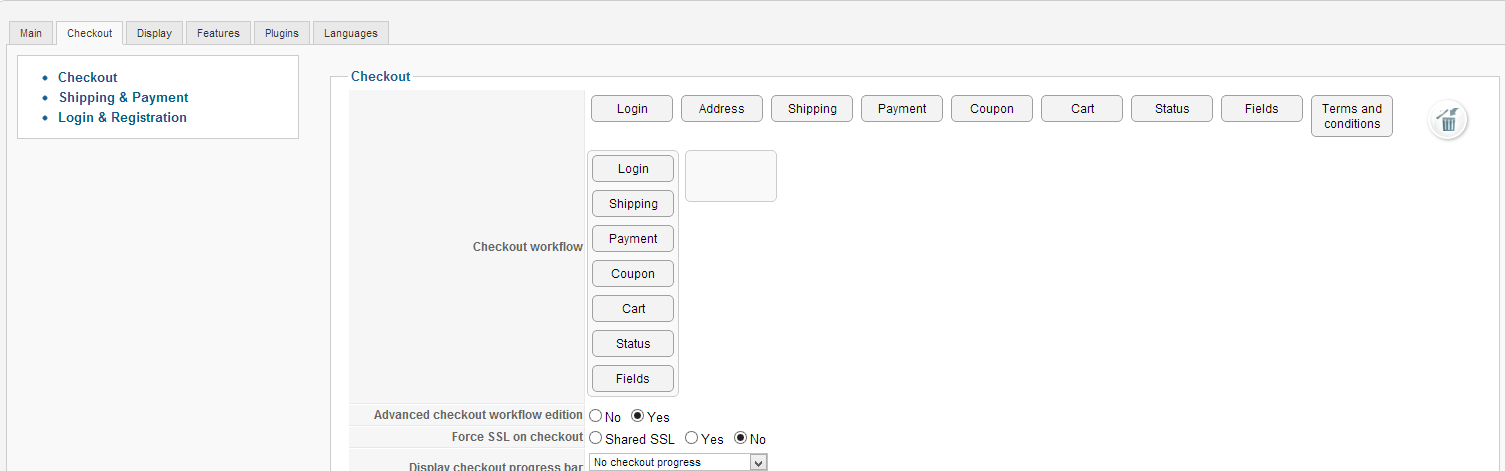

I can only get this registration details to appear at checkout if I add 'Login in'to the checkout workflow' but as I am using the starter version registration in is not available, your populate the details click register and nothing will happen.
11 years 10 months ago #90662
Ok, so my solution is to :
- Go to "Hikashop->Display->Views"
- Edit the file "registration" of the view "user"
- Add your code
But it would require some php knowledge.
