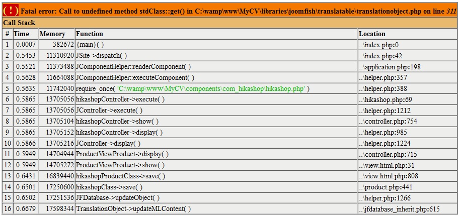

I am having an issue with Joomfish:
I see all Hikashop elements in Joomfish correctly and translated some of them to try and everything show perfectly on my product listing page. French and English.
However, when I click on the product page link I get a Fatal Error:
Fatal error: Call to undefined method stdClass::get() in C:\wamp\www\MyCV\libraries\joomfish\translatable\translationobject.php on line 311 (screenshot attached).
It still works fine in English, it is only when I switch to French that this happens.
(I have selected yes and yes in Hikashop Parameters language tab)
Any idea where this might be coming from?
Thank you

11 years 10 months ago #92979
That error is in JoomFish. You should contact JoomFish.
As a simple workaround, you can try to remove the code
$key = $dbObject->get('_tbl_key');
		$db->setQuery("SELECT * FROM " . $dbObject->get('_tbl') . " WHERE " . $key . "='" . $dbObject->$key . "'");
		$origObject = $db->loadObject('stdClass', false);
in the file libraries\joomfish\translatable\translationobject.php
That should remove the error.

11 years 10 months ago #92982
It worked perfectly, thank you so much! (and so quick as well!!)
