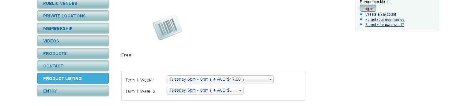

I have an option setup called "Term 1 Week 1" and added to this option is a variant:
For example Tuesday 6pm - 8pm ( + AUD $17.00 )
Could you tell me how I can display the remaining quantity for the variant
For example:
Tuesday 6pm - 8pm ( + AUD $17.00 ) Remaining Spots: 5
Thanks for your help
Patrick
11 years 9 months ago #93427
You can edit the view "product / option" and use the var "$optionElement->product_quantity" to display the quantity where you want.
  • Posts: 100
11 years 9 months ago #93685
HI Xavier
I changed line 87 in file product\option.php file
$text.=' ( '.($positive?'+ ':'').strip_tags($this->loadTemplate()).' )' . " " . $optionElement->product_quantity;
However, if I have
Option 1 Variant 1 - quantity = 3
Option 1 Variant 2 - quantity = 4
The quantity 3 gets displayed for both Variant 1 and Variant 2.
Could you tell me if that is the correct file and where I should add $optionElement->product_quantity
thanks
Patrick
  • Posts: 83048
  • Thank you received: 13407
11 years 9 months ago #93967
$optionElement->product_quantity is the quantity of the default variant of the current option.
You should use instead $variant->product_quantity which is the quantity of the current variant of the current option.
