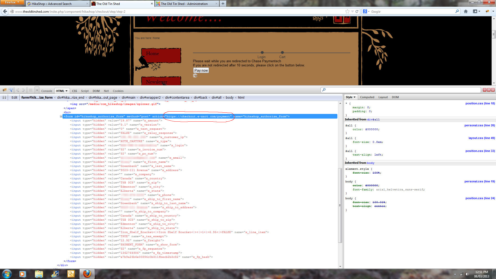

I created a website and am using hikashop shopping cart along with the authorize.net payment plugin. The checkout was working while the site was located on a testing domain. We just migrated the site to the live domain and now the checkout button does not forward to the payment gateway / hosted checkout like it did before. When "next" is clicked to checkout, the screen re-directs to the usual "If you are not re-directed within the next 10 seconds click the Pay Now button below (or something like that)"... but it doesn't re-direct to the hosted checkout url and the "Pay Now" button doesn't do anything either, the page just sits there.

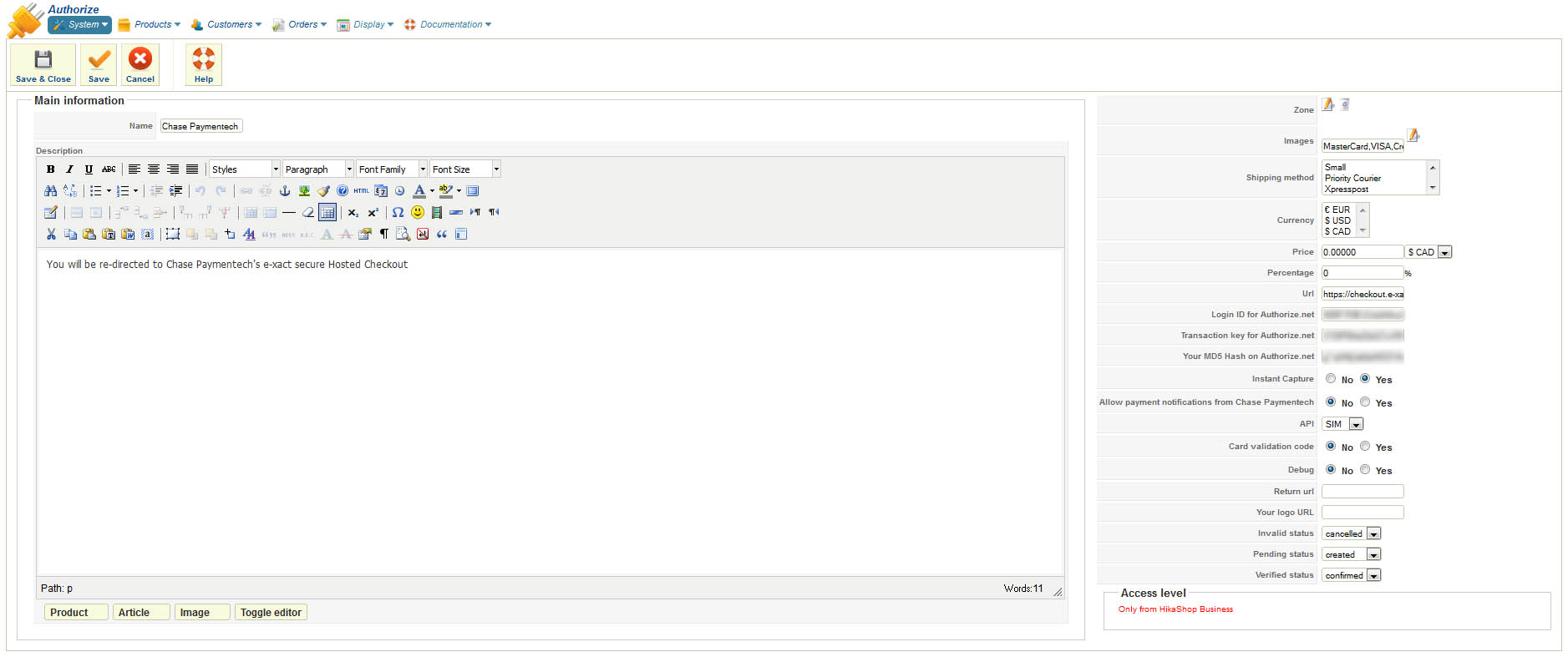

I've updated all the necessary settings on the hosted checkout side to match the new domain (and they have confirmed that the settings are correct). I've also changed every setting that I can think of on the hikashop side to match the new domain. Though the actual payment plugin parameters didn't need any changes that I could see. Any ideas?
Further to what I've written above, I've attached a screenshot showing what the page is displaying as well as what firebug reveals in the form inputs. I've circled the hosted checkout url in the form tag - this is where the shopper should be re-directed to.

Here's some more info... should the checkout url be included somewhere in the code of the checkout button ("Next"), if so, I don't see it here as revealed by firebug... see screenshot...

In the "Url" option of the "Autorize.net" payment method you should have " secure.authorize.net/gateway/transact.dll " can you check if it's the case ?

Thanks for your reply. The payment gateway company uses authorize.net but operates it through their own system somehow. The url they gave is not the same as the one you have suggested, though I tried the one you suggested and it didn't change anything. The url they gave was working prior to me migrating the site. With both url's the "next" button which should re-direct shoppers to secure checkout doesn't go anywhere. It seems as though the button just doesn't contain the necessary code to re-direct at all? I've checked all I know to check. Is there something in the configuration that needs to be changed?

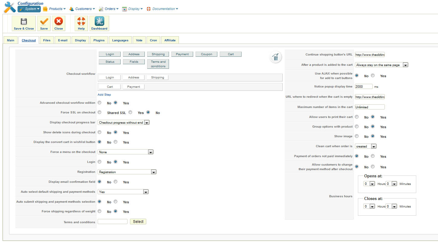

Thanks for taking a look at the site. I think that a shipping method couldn't be found because the Canada Post plugin couldn't read your address. I have test accounts created for a user in Alberta and it works fine. I believe the plugin assigns a shipping rate based on the province and a postal code and the postal code in the address you created would not have been considered valid (5 numbers would work for the U.S.). You could use something like this: T5B 0C3, and it should work.
Even so, I have the checkout process configured for two steps. The first steps is login and shipping. Getting past the shipping step has not been the problem, the canada post plugin has been working fine. It has been the checkout step that has not been working. The cart has been assigning tax and shipping just fine, but when the "Next" button is pressed to take the customer to the hosted checkout it has not been going anywhere, and the settings in the authorize.net plugin have been verified as being correct. And as mentioned, it worked with the exact same settings on the test site. The "Next" button was re-directing customers to the Chase Paymentech hosted checkout using the authorize.net plugin.

The issue comes from a javascript error:
Uncaught TypeError: Cannot call method 'set' of null on line 66
in the file www.theoldtinshed.com/templates/beez_20/...t/md_stylechanger.js of your template.
Because of that the javascript of the redirect cannot run at the end of the checkout and it stays there. You could try to correct (remove?) that line of the template js file to circumvent the problem.
Regarding the fact that the button cannot be clicked, that has actually been already fixed and you would have to either update HikaShop or just copy the file back/extensions/plg_hikashoppayment_authorize/authorize_end.php in the install package of the latest version to plugins/hikashoppayment/authorize/authorize_end.php on your website to fix it.
