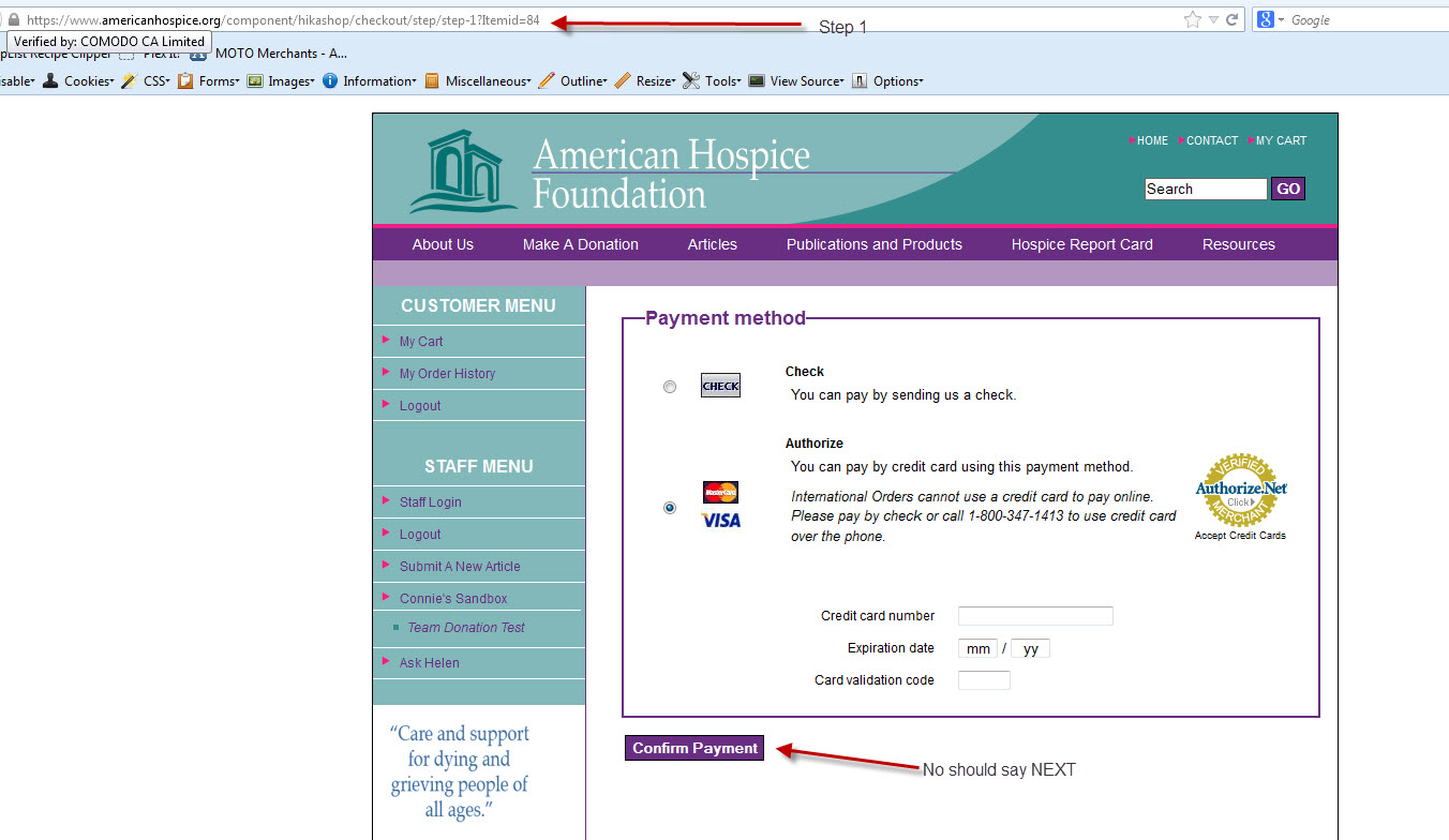

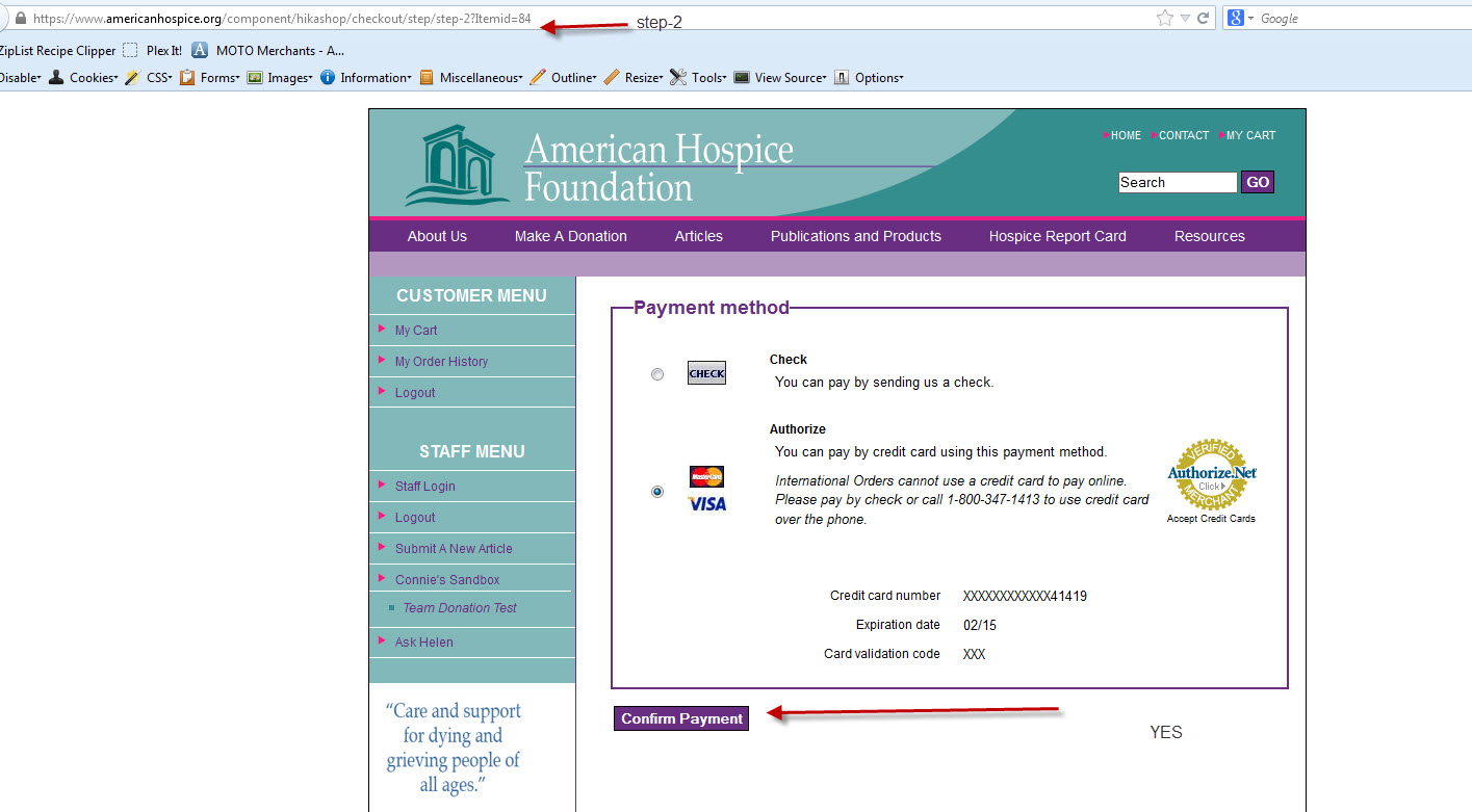

No, I wasn't editing the correct template. Now I can see a change, but now the "Confirm Payment" is showing on both the form where the payment information is filled out and again on the confirmation screen. Is there a way to check more finely? I attached screenshots.
Also, I added quotes around the 1. Could that be wrong?
here's my code again:
if($this->step=='1'){
echo $this->cart->displayButton('Confirm Payment','next',$this->params,hikashop_completeLink('checkout&task=step&step='.($this->step+1)),'
if(hikashopCheckChangeForm(\'order\',\'hikashop_checkout_form\')){
if(hikashopCheckMethods()){ document.getElementById(\'hikashop_validate\').value=1; document.forms[\'hikashop_checkout_form\'].submit();
return false;','id="hikashop_checkout_next_button"');
else{
echo $this->cart->displayButton(JText::_('HIKA_NEXT'),'next',$this->params,hikashop_completeLink('checkout&task=step&step='.($this->step+1)),'

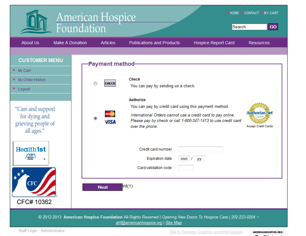

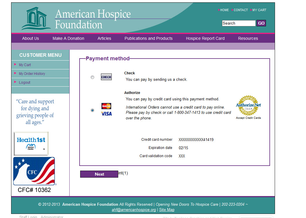

  • Posts: 43
11 years 11 months ago #95780
It says "1" on both pages. I attached screenshots so you can see. Any other ideas? At least we know for sure it's step = 1!
  • Posts: 26201
  • Thank you received: 4032
11 years 11 months ago #95828
Your two screenshots are for the same step.
Both displayed the payment method selection, but the second one is just after the credit card completion (where the information are display for checks).
