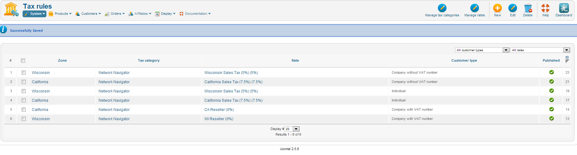

  • Posts: 17
11 years 11 months ago #95826
I thought it might be helpful to include this screenshot of my configuration as well.
  • Posts: 83378
  • Thank you received: 13486
11 years 11 months ago #95919
From what you're describing, it sounds that you changed the hikashop configuration option "Default address type" from "individual" to something else and thus the users are not identified as individuals anymore. Could you check on that ?
Also note that 0% tax rules should not be necessary.

  • Posts: 17
11 years 11 months ago #96185
I checked the default address type in configuration, and it was set as "all customer types" I changed it to "individual" and now it seems to be working perfectly. Thank you so much!
