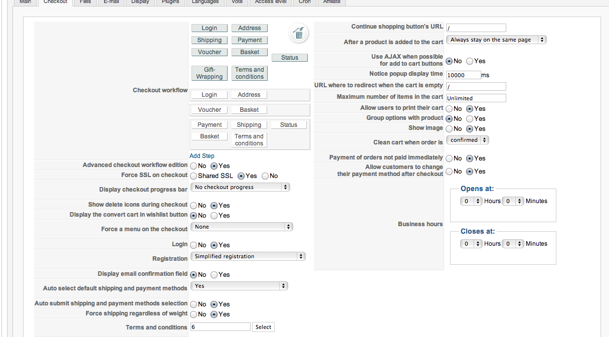

  • Posts: 79
11 years 11 months ago #95028
I've attached a screenshot of my checkout configuration. Does everything look ok?
  • Posts: 83345
  • Thank you received: 13481
11 years 11 months ago #95055
That looks ok. Make sure that you're using the latest version as I recall fixing things in the checkout for 2.1.1 regarding reselection of shipping/payment methods during the checkout.
