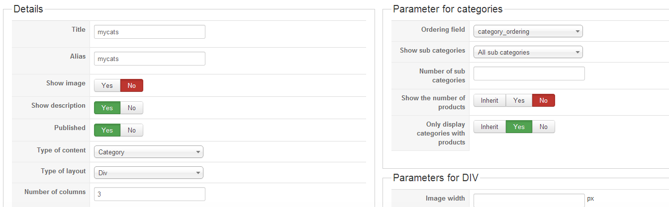

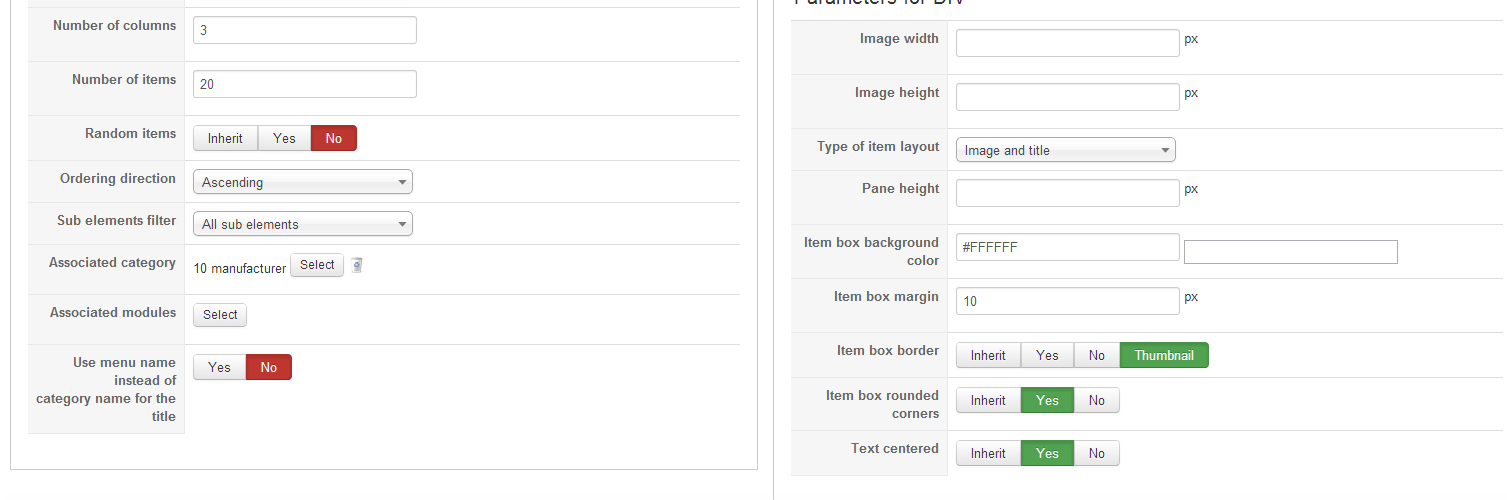

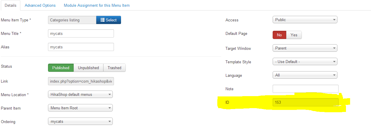

  • Posts: 223
11 years 6 months ago #109553
here are current settings....
  • Posts: 83041
  • Thank you received: 13405
11 years 6 months ago #109556
There is no associated products listing module attached to your menu so that's why you don't see any products wen you click on that link.
