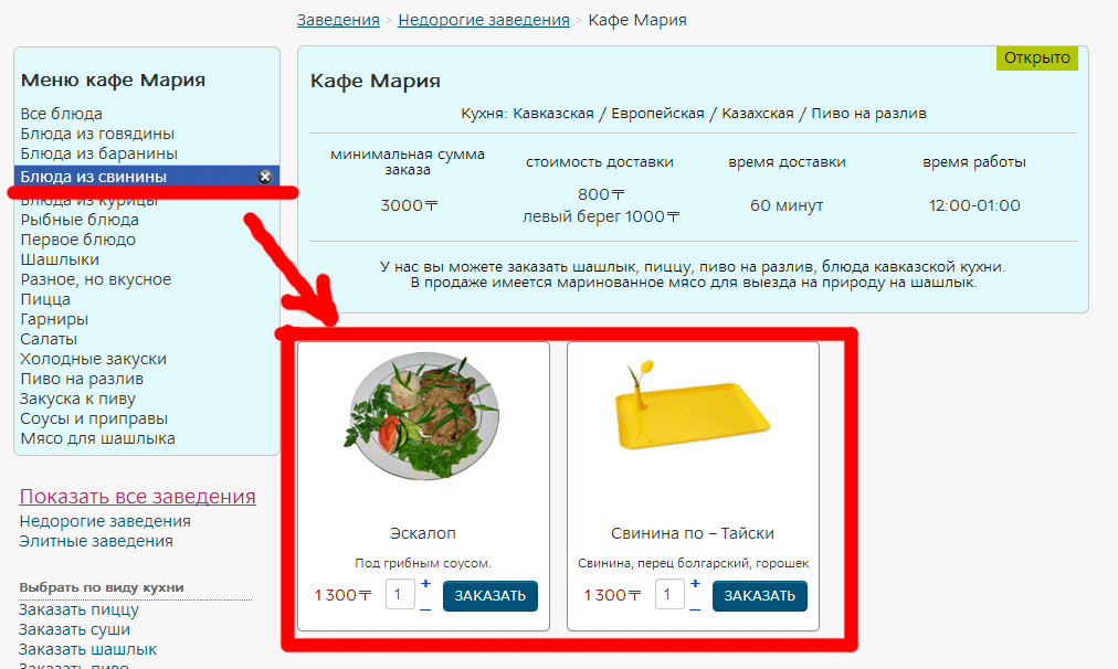

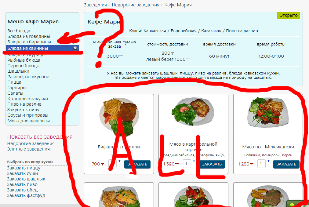

11 years 9 months ago #113864
PeterChain wrote: Anyway this is not still the right solution as you may get reseted filter but the Filter controls remain with the X sign to get them cancelled even they are already cancelled.
Yes. Filter module shows that filter is applied, but all products from category are listed. How to reset selection in module too? It confuses the site visitors.

It's in russian. I think you don't understend anything on this site.
When I use filter, it works and show for example 2 products from category
But when I change category and then return here again, there will be listed all products, but filter module shows like filter is still applied. But really no filter is applied.

  • Posts: 2334
  • Thank you received: 403
11 years 9 months ago #114087
Hi Marius,
I found the source of the issue, it's because you activated the joomla's cache.
That's why the filter is working but not displaying the right informations, the page is cached.
So you ahve to disable the joomla's cache and if you really want to have a cache you must find an extension to specify the pages you want to cache (not the Hikashop ones)
