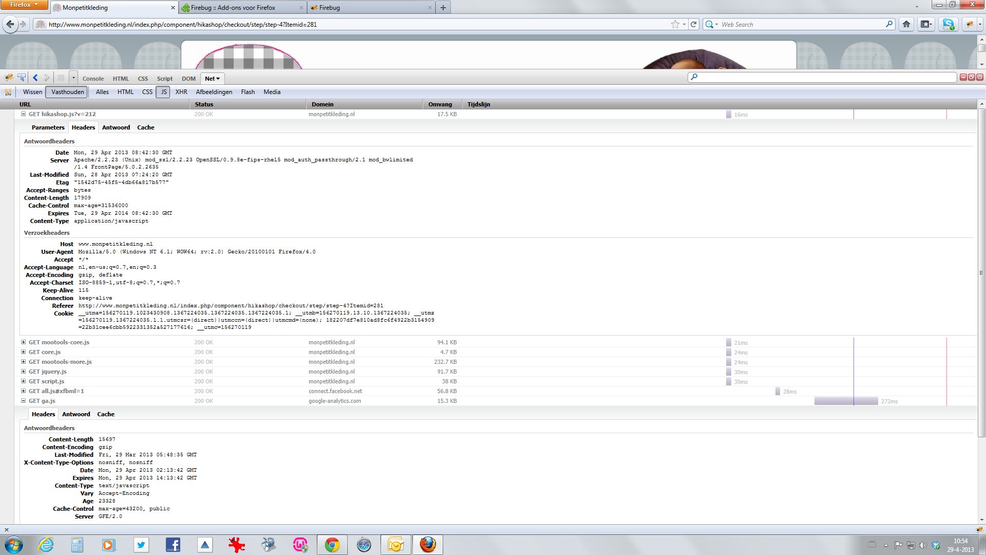

The log file for java I can't find (Chrome "element inspection")? Can you give me a direction to find the log.
Do you have new idea to solve this problem?

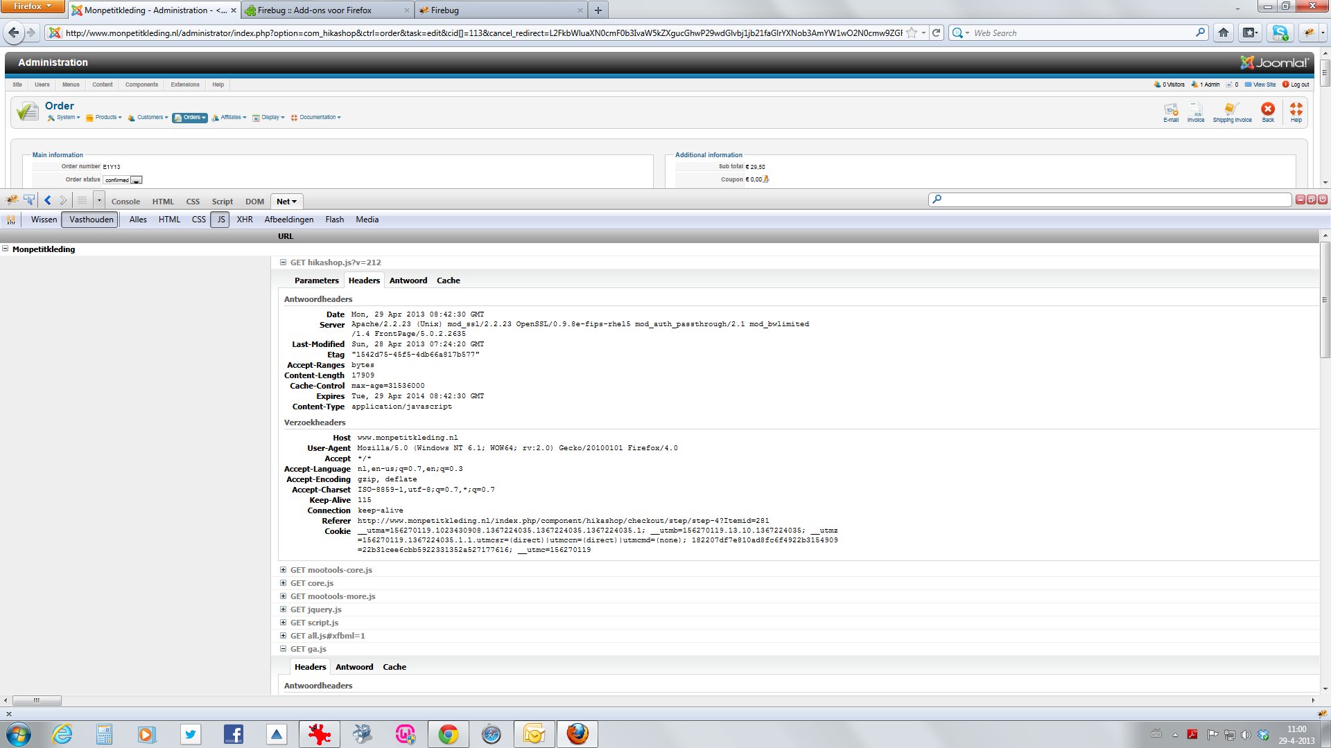

If you turn on the debug mode of the GA plugin, it will use that method to be able to see what's going on during the confirmation:
developers.google.com/analytics/resource...ubleshooting#gaDebug
So if you have that option turned on in the plugin and the plugin published and the firebug console of firefox opened while you confirm the order status of an order in the backend, you will see the debug information printed in the console and potential errors.
That will allow us to understand what's going on.

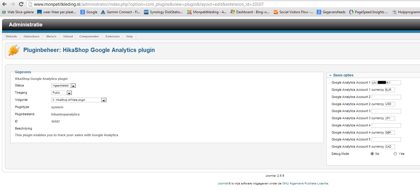

  • Posts: 106
11 years 9 months ago #101407

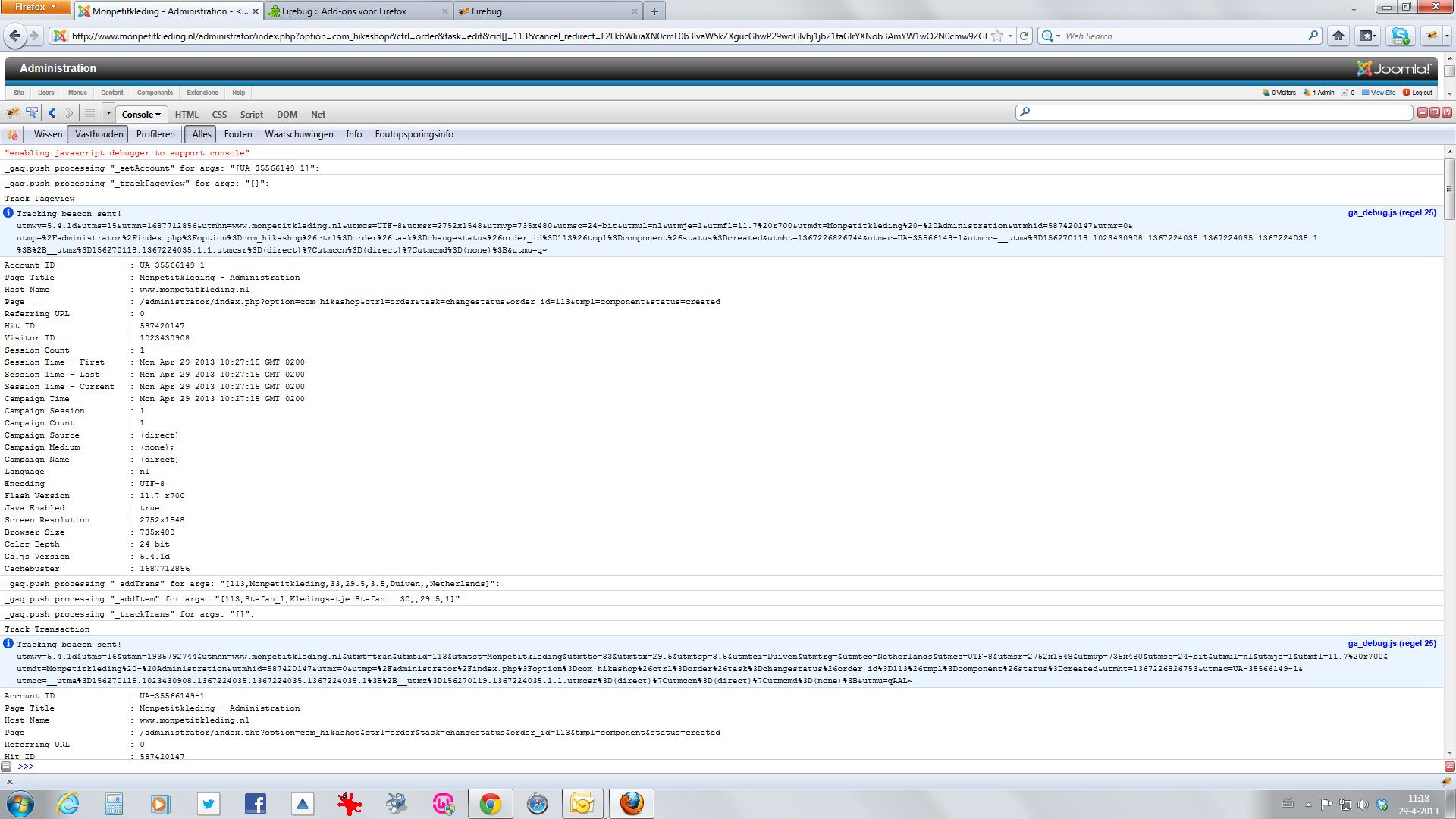

Is this where you looking for?
The debug mode of hikashop plugin is on "yes"
I hope you can help me with this.
Best regards,
Gerard

  • Posts: 83326
  • Thank you received: 13471
11 years 9 months ago #101672
Your last screenshot is indeed what we need:
www.hikashop.com/media/kunena/attachment...ytics_back-end_2.jpg
As you can see on it, the order details (orer id 113 by someone in Duiven, with 1 product Stefan_1 costing 29.5) are properly sent to Google Analytics.
And the debugger doesn't give any error so it is successful.
You should normally see that order in the ecommerce area of your GA account less than 48h after that (it can take several hours).
If you don't see it after 48h, then maybe there is an issue with your GA account. I encourage you to contact GA's support with that screenshot and ask them why you don't see the transaction in your account.

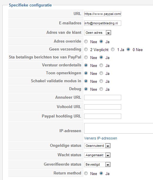

Is the settings for paypal right to get the info in GA?
Is there a other way to test de payment proces?
beste regards, Gerard
Last edit: 11 years 4 months ago by gerardtb.

There is no link between paypal and the google analytics plugin.
One is for the payment, communicate with the payment process and the other, add data to send details to google.
When an order is confirmed, the plugin store the details in the session and display it in the next "valid" page.
That's how the plugin works and it works good in the backend for what I tested.

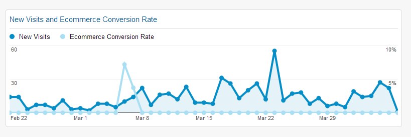

Till now I get only 5% responds to GA. I hope the update gives improvement.
Thanks for your time, Gerard

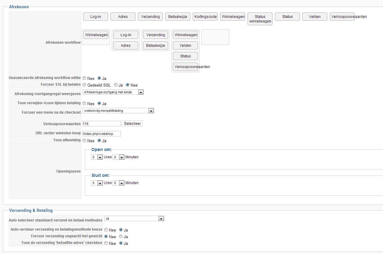

  • Posts: 68
  • Thank you received: 6
11 years 3 months ago #132588
A question related to this thread.
Do we have to use the standard 'Thank you page' of Hikashop (which I am guessing is using the View after_end) for GA Ecommerce to work?
In my case we have customized the Paypal Return URL to a specific page so I think the GA Ecommerce plugin is not activated.
Is my understanding correct?
  • Posts: 106
11 years 3 months ago #132596
I don't understand you question.
How can I implement the "Thank you page" or is it "standard "implemented in the checkout or is it part of the payment plugin of hikashop.

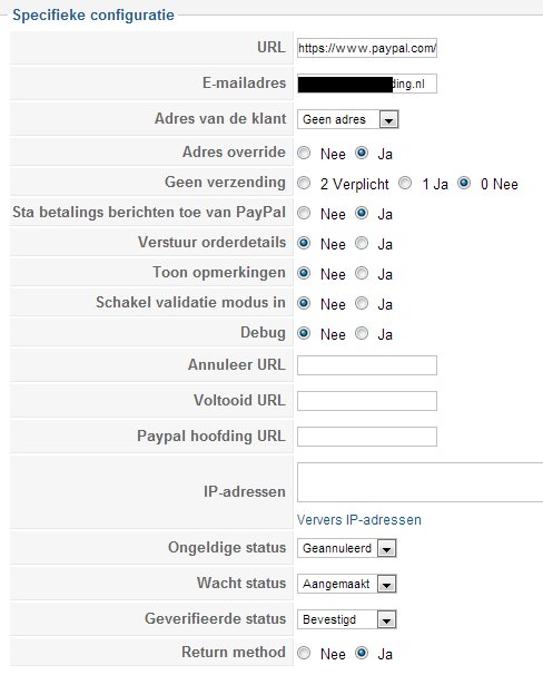

I attached the checkout and paypal screen dumps.
Maybe the problem is that I don't understand the checkout/payment process of Hikashop in combination with GA.
I hope you can help me with this and solve the problem.
Thanks For your time.
Best regards, Gerard
