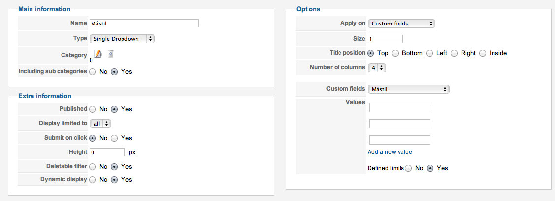

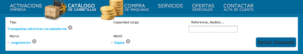

I have a setup of 5 filters in a module, all work as expected when selected showing the X icon bring them back, but there is one that just shows the filter title without giving the chance to delete it.
I tried all possible combinations in the filter setup with no lick, so I might be missing some HikaShop fundamental concept or (unlikely) there is a bug.
this is the problem
and this is the actual setup (even I changed most of all switches in all kind of combinations)

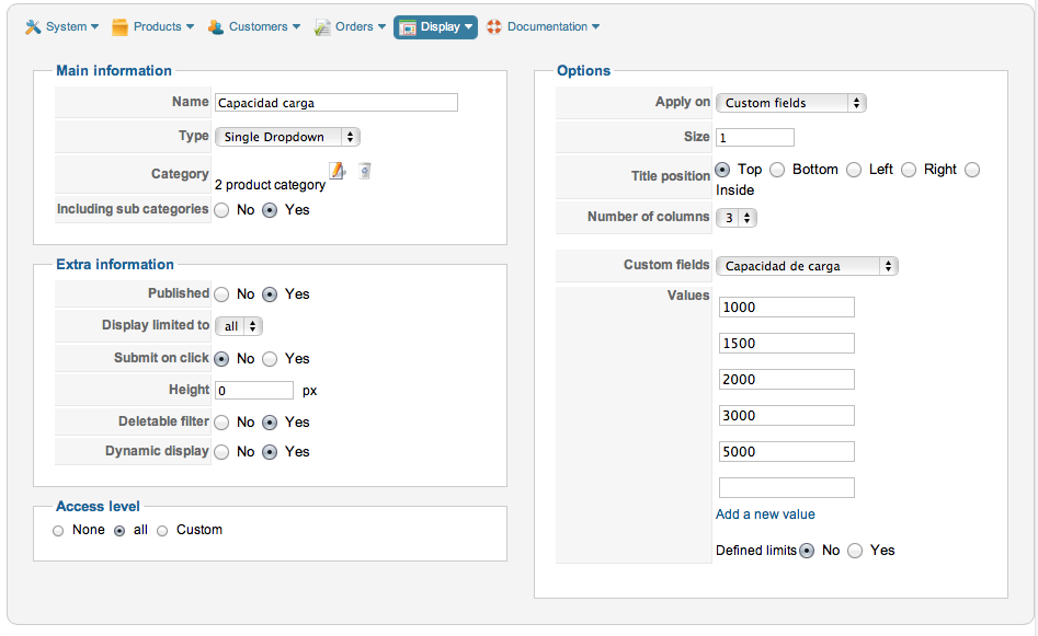

If I disable both the content stays on screen, but it doesn't make sense as I want it deletable as all other filters in the module.
Once I enable deletable the problem comes back.
Yesterday I sent you login data through your Contact form in the HikaShop website.
This is the code I get for the filter
<div class="hikashop_filter_Carga"><span class="hikashop_filter_title">Capacidad carga</span> <br></div>
which is quite different from the other filters containing the extre code to Delete it,
The difference in the Filter setup with other filter units is that this one has its values entered in the filter itself while other filters take it form a category, this is the only difference I can see, so maybe there's a bug during the construction of the filter depending of where it comes from?

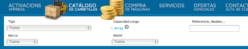

NOW THE FAULTY FILTER Delete Buttons is working fine, BUT I get the word "Array" instead of the values I selected once the filter is activated.
This is the HTML code that gets generated for this piece Filter Module:
<span class="hikashop_filter_title">Capacidad carga</span> <br>> <a class="hikashop_filter_list_selected" style="font-weight:bold">Array</a>
<input type="hidden" name="filter_Carga[]" id="filter_Carga_module_111" value="1500::2000">
<a href="#" style="cursor:pointer; text-decoration:none" onclick="document.getElementById('filter_Carga_module_111').value=' '; document.forms.submit();return false;"><img src="/activacions/media/com_hikashop/images/delete2.png"></a>
<br>
</div>
