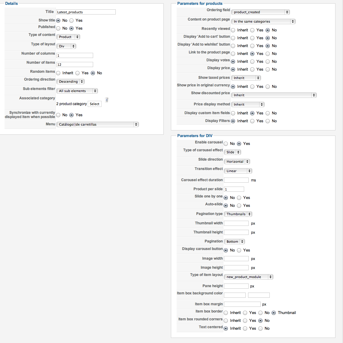

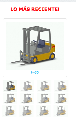

I have a Content_Module listing products in carousel mode. If I am not wrong some days ago each thumbnail was changing the central product once clicked. Now the "Hand" cursos appears when hovering on the thumb, but it is not reacting.
I have a custom view for the module, but when using default views the problem persists so I think it is not my fault.
I could not find any similar post in the forum so maybe it has to do with latest versions...
this is my setup for the module.
