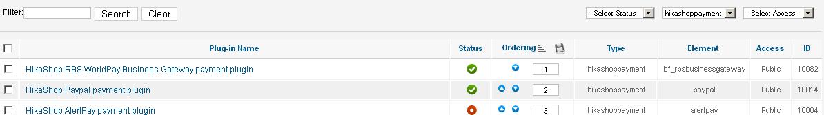

11 years 9 months ago #104088
Hi Nicolas, please see the picture attached. Worldpay is indeed the first in the ordering!
11 years 9 months ago #104139
And have you tried to clear the cache ?
