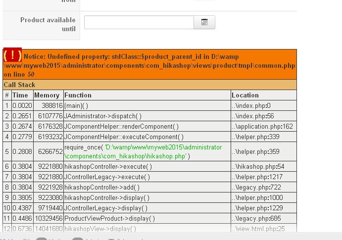

Hi, my friend,
i found Hikashop is a fantasitic e-commercial component. i want to buy business vesion soon.
Now i'm useing the free vesion for trail, but i met a problem when i add a problem,
please check the follong Notice picture. please try to help me to solve this problem. thanks.
I'm waiting for your reply!
Have a good day!
Best regards,
David lee

  • Posts: 4
11 years 10 months ago #99858
Thanks for your prompt reply, Jerome.
please check the attachment for the picture.
hope you can help me.
best regards,
david
11 years 10 months ago #99929
I don't have something like that in this view on my local website.
Have you edited this view ? Can you give me the corresponding lines of this files ?

  • Posts: 4
11 years 10 months ago #99932
Thanks for your reply.
yes, i met this problem when i add new problem, in my localhost.
how can i solve this problem?
Waiting fo your reply.
david
  • Posts: 83326
  • Thank you received: 13471
11 years 10 months ago #100024
Turn off the "error reporting" option of the joomla configuration and you won't have the problem anymore.

  • Posts: 4
11 years 10 months ago #100093
Thanks, nicolas.
it's much helpfull. solved already.
have a good day.
best regards,
david lee
